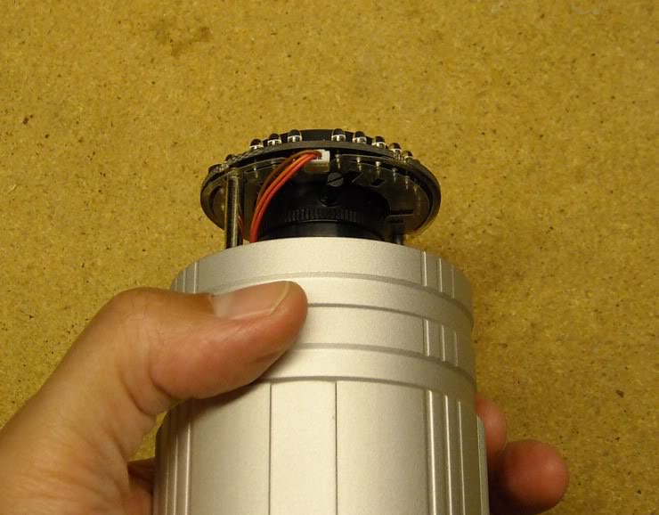

Sawbones 0 Posted December 8, 2010 If you want to mount in a window, the ir will refect bk into the lens and destroy cam at night Truth, right there. However, the LEDs in the Acti 1231 can be unplugged: Share this post Link to post Share on other sites

rory 0 Posted December 8, 2010 If you want to mount in a window, the ir will refect bk into the lens and destroy cam at night Truth, right there. However, the LEDs in the Acti 1231 can be unplugged: Yeah but like most current TDN IR bullets does that also disable the Day Night feature? Eg. many will stay in BW if you do that now and never switch over. Share this post Link to post Share on other sites
bpzle 0 Posted December 8, 2010 Rory's right.... there's a photocell on that board. Can't remember if the camera uses that just for the IR to kick on or also uses it to switch beween day/ night. On my analog cams there's a feature in the OSD to use video level or to use the photocell. I don't think that option exists in ACTi's configuration... Share this post Link to post Share on other sites

Sawbones 0 Posted December 10, 2010 Rory's right.... there's a photocell on that board. Can't remember if the camera uses that just for the IR to kick on or also uses it to switch beween day/ night. On my analog cams there's a feature in the OSD to use video level or to use the photocell. I don't think that option exists in ACTi's configuration... There are two sets of wires that go to the IR LED assembly. One set undoubtedly goes to the photocell (and you wouldn't want to disconnect those, of course), but the other set powers those LEDs. Here's one side of that LED assembly. And here's the side I already posted: Share this post Link to post Share on other sites
rory 0 Posted December 10, 2010 Thats how they should be, but every new one ive used lately has only 1 cable to the LED ring. Good to know their new cameras are sticking with some good old tricks Share this post Link to post Share on other sites

Sawbones 0 Posted December 10, 2010 Thats how they should be, but every new one ive used lately has only 1 cable to the LED ring.Good to know their new cameras are sticking with some good old tricks That one's a year old or so... so maybe it's the older ones that had separate wiring to that LED assembly. Share this post Link to post Share on other sites
bpzle 0 Posted December 10, 2010 Thats how they should be, but every new one ive used lately has only 1 cable to the LED ring.Good to know their new cameras are sticking with some good old tricks That one's a year old or so... so maybe it's the older ones that had separate wiring to that LED assembly. Last one I used was seperate... I remember now. That was about 6 months ago... That ir would be no where near powerful enough for lighting up a driveway. Probably throws a 10-15 degree beam maybe 15-20' outdoors. Share this post Link to post Share on other sites
Sawbones 0 Posted December 10, 2010 Thats how they should be, but every new one ive used lately has only 1 cable to the LED ring.Good to know their new cameras are sticking with some good old tricks That one's a year old or so... so maybe it's the older ones that had separate wiring to that LED assembly. Last one I used was seperate... I remember now. That was about 6 months ago... That ir would be no where near powerful enough for lighting up a driveway. Probably throws a 10-15 degree beam maybe 15-20' outdoors. It's a little wider than that... but you've got the distance about right. You just can't push enough power over PoE to generate decent wide-area IR coverage. Share this post Link to post Share on other sites
