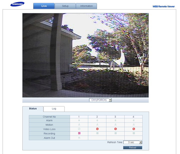

Here's what I'm looking at on Chrome. Please note: The cam image is sitting inside, not mounted, looking through a screen window (screen + glass) and in a poorly lit area. Again, it's just in test mode so far. Yes, that's a wooden deer, festive, I know.
Very cool... well it's hard to tell the camera quality through the screen and what not. Let us know when you get one mounted outside, would love to see that.

If you are following my saga, you'll be glad to know the Samsung SDE-120N is installed. The equipment seems to work quite well for the price. The screenshot below shows the view from my the Internet Explorer quad-view. I may post more screenshots later, but I'm feeling lazy. Obviously, the best quality is on the VGA output of the DVR.
The cameras are probably not pointing where they will aim forever, with the exception of the front door camera. I'm amazed by the cameras wide angle; I was able to cover front windows, part of porch and door, all with one camera (it's infrared, by the way).
The other two cameras on the front yard are color cameras and work pretty well in low light. The back camera is the other IR camera. I'm not thrilled with the positioning and the back yard is basically zero light. When I turn on the floods or the motion sensor sets them off, the camera works decently well. I'm considering an IR flood setup of some kind for the back yard.

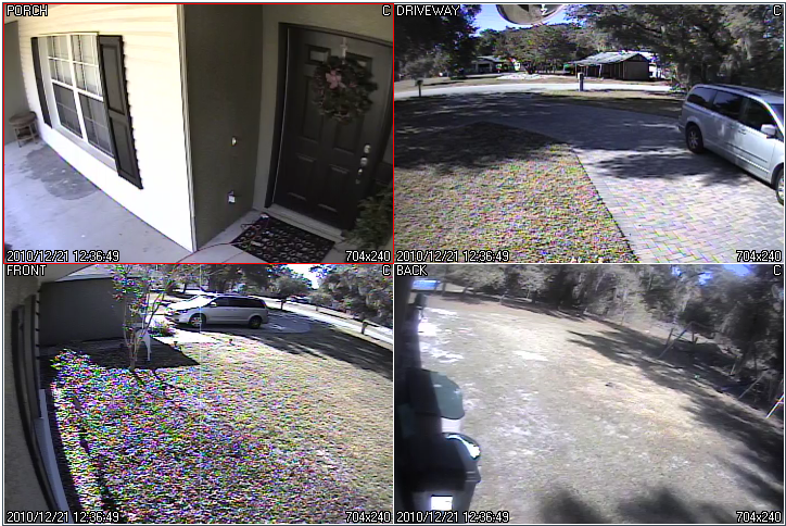

I figured I'd post a general update after answering the last question. The cameras are still working well, but I have found I don't use the remote viewer as often as I thought I would. Funny enough, using this system I found out my yard guy was doing more work than I thought, so I gave him a little bonus.

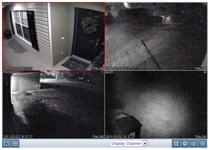

I haven't posted any nighttime images from the web viewer. Below is an image I captured just a minute ago. Please keep in mind that it looks MUCH better in full resolution on the monitor attached to the DVR. The web version is always lower quality, and its really obvious at night. If you could see the monitor, you'd be amazed at the quality difference at night between it and the web.
You can see my frustration with camera four (back yard), and my need for more lighting. It's very dark and rarely lit. Objects show up well, but I'd like a nice picture like I get in the front yard with the ambient light that is there. Obviously the short throw IR camera on the porch works perfectly in any light.
I have had trouble getting the sensitivity settings just right, so I get a lot of birds and bugs. Especially at night on camera four, it's triggering stupid motion alarms all night. I'm sure this is all just my fault. My wife is in love with the system, and told me she wasn't so sure when I first proposed the idea, but now she's glad I chose to do this.

Thanks for posting, it's always interesting see results. Looks pretty similar to a Lorex in quality that I had once upon a time.
Motion floods will solve the lighting. On the other hand constant lighting can be a pretty good deterrent.
I had the same problem with the bugs, the IR attracts them. CNB makes a good external IR unit at a reasonable price ~90 if you go that route. I would get the wide angle version.
