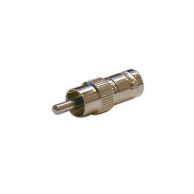

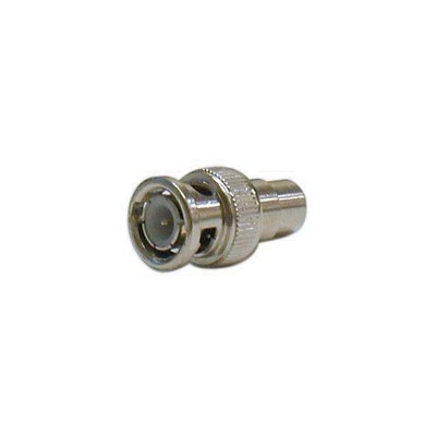

Forgot to mention, option 2 seems a lot cheaper to since monitors with BNC input seem ridiculously expensive... why is that?!
Yet monitors with VGA/RCA/etc inputs are much more cheaper.
Mostly because BNC connectors are used mainly on "professional" grade equipment... it's not more expensive because of the connectors, it's because the connectors are relegated to higher-end displays that are inherently more expensive.
The cheaper option is:
