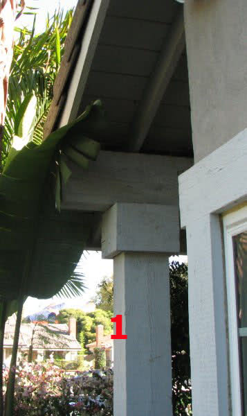

I'm planning to install a dome cam on this solid wood post, in roughly the spot labeled '1':
This post supports a solid wooden beam that runs the entire width of the house. My current plan is to run some gray PVC conduit along the top of this beam to reach the post:
The whole area is sheltered by the roof, but a strong wind might blow some rain onto the camera and conduit; however, the PVC conduit should be reasonably water-tight so I should be all right, shouldn't I?
The area labeled '2' is the outside wall of the garage; this would be the easiest wall to penetrate to bring the wires into the house. At the post end of the conduit, however, I'm having trouble coming up with a good way to make the right-angle turn to run down the post to where the camera will mount.
Any ideas on how to complete the run? Is there another approach I should consider?
Thanks for sharing your wisdom.
The PVC should be completely water-tight if you glue the sections together with proper PVC solvent.
To right-angle down the post, you could use this:
Or this:
Or use ENT (electrical non-mechanical tubing):
Or use Liquidtight tubing and fittings... you could terminate the pipe with one of these:
Then thread in one of these:
Add another to the camera housing, and connect with the flexible tubing.
