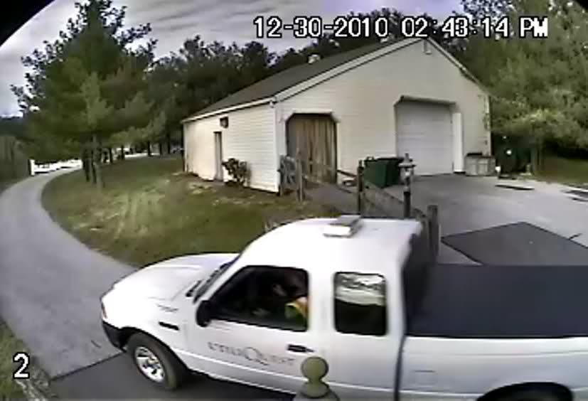

Merlin3100 0 Posted January 2, 2011 Hi Group, I'm installing my first 16 cam system. The cams I'm using are IR, color, 550 & 600 TVL cams with External Zoom & Focus Adjustable. My question is, no matter how well I adjust them out I see what looks like ripple lines on the edge of items in the image. You will see it the best on things with straight lines as if I'm looking out through a window with a bug screen? Sometimes it looks like a ripple effect or hash marks as things move through the image. The other thing I see is something that looks like the image looks like it's sparkling or moving in some way. I think what I see is called "Electrical Noise". All of my cams have DNR, but none of the settings seem to make any difference in the image. It is not bad but I would not consider perfect. But like I said, this is my first system and maybe I'm expecting to much. Thanks in advance for any help, The cams I'm using are KT&C , KPC-N500 http://www.ktncusa.com/english/viewtopic.php?t=682# Share this post Link to post Share on other sites

rory 0 Posted January 4, 2011 Please post the original image, hard to tell with the scanned image. You can upload them to tinypic.com then post the forum link it gives you. Thanks. Share this post Link to post Share on other sites
Merlin3100 0 Posted January 4, 2011 (edited) rory said: Please post the original image, hard to tell with the scanned image.You can upload them to tinypic.com then post the forum link it gives you. Thanks. I'm not sure if I did this correctly but here it goes. Edited January 4, 2011 by Guest Share this post Link to post Share on other sites
Merlin3100 0 Posted January 4, 2011 OK... If you look at the picture http://i56.tinypic.com/w9d2ea.jpg check out the straight lines on the truck and roof line on the building. On the trucks door at the bottom of the drivers window, as well as the lower body lines on the door, you can see what I describe as some type of hash marks. The same on the edge of the roof line. It's not as bad in this picture. But you see It more when you see the live motion of the truck driving by at 15-20 mph. The settings on the DVR for this camera are as follows; Compression: H.264 Resolution: CIF Frame Rate: 30FPS Bit Rate 1024Kb/S Any thought what might do this or maybe an adjustment I need to do? Share this post Link to post Share on other sites
tomcctv 190 Posted January 4, 2011 what make of dvr are you using ?? Share this post Link to post Share on other sites
D.V.S. 0 Posted January 4, 2011 That's an interlace problem. Either de-interlace or if your dvr automatically de-interlaces then try to manually de-interlace the video yourself. My lorex dvr does the same thing as it does not automatically de-interlace. edit: I see that you are recording in CIF. The above does not apply to CIF since it is non-interlaced. Your video is normal for CIF recording. Try recording in D1 at 7fps. Share this post Link to post Share on other sites

rory 0 Posted January 5, 2011 Merlin3100 said: Dirk_D said: What kind of DVR? This is the DVR I'm using: http://www.watchnetdvr.com/embeded_es_rt_kit.asp The 16 camera model. Its a Dahua DVR as far as I can tell. Slight Jagged edges seem to be common with it. But increase the encoding to D1 if you havent already. Even better if you can download a short video clip and convert to avi then post here. Just to verify, it backs up in .DAV format right? Share this post Link to post Share on other sites
