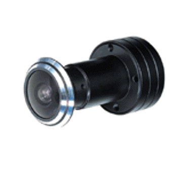

I'd also like to know how to do a door camera that would be able to see visitors' faces, yet not be up in their face?
Put something like this in your door?
