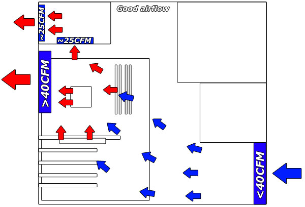

That said, heat is your biggest enemy, with power instability being a close second. You don't have to refrigerate your machines or anything, but having sufficient, properly-routed airflow is critical. That doesn't mean just loading the case up with fans, either; you just need to place and align the fans to keep air moving through smoothly, and it will carry the heat away.
