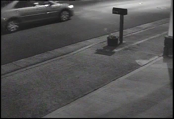

D.V.S. 0 Posted January 6, 2011 (edited) On my CNB's I set the LENS setting in the menu to ESC instead of DC. No motion blur with any moving objects, day or night. edit: Well some motion blurring at night. Car about 20mph on a moonless night. Edited January 6, 2011 by Guest Share this post Link to post Share on other sites

cglaeser 0 Posted January 6, 2011 Car about 20mph on a moonless night. Judging from the shadows, appears to have a street light as well. Best, Christopher Share this post Link to post Share on other sites

D.V.S. 0 Posted January 7, 2011 Judging from the shadows, appears to have a street light as well. Yes. That's a shadow from a tree lighted by a street light 200 feet away. There is also a street light 40 feet in front of the car. The Cnb adjusts shutter speed very well automatically, at least in my application. Share this post Link to post Share on other sites

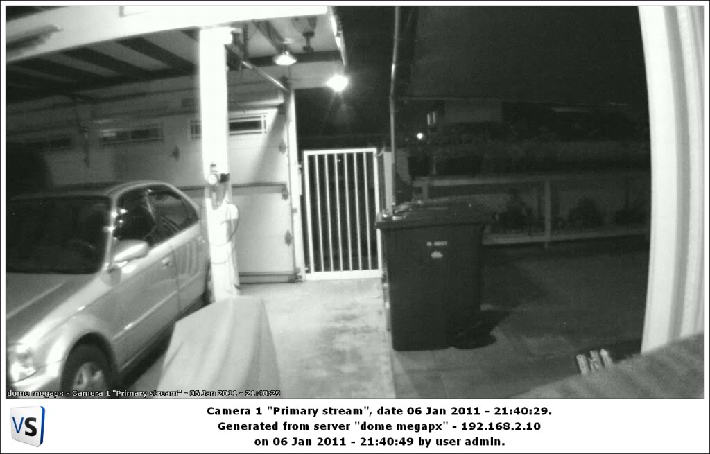

D.V.S. 0 Posted January 7, 2011 I don't like when moving objects are recorded and all you get is a blur. That's why I use the electronic shutter. Here's the network cam I told you about, lighted by 18 watts of spiral fluorescent. Share this post Link to post Share on other sites
