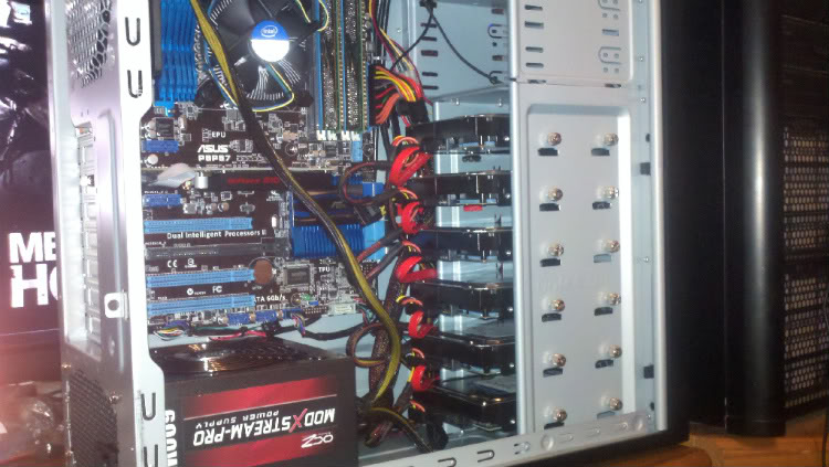

Todd 0 Posted January 14, 2011 I've got some pictures on my phone. I'll get them up at some point in time. Using the Asus P8P67 and the 2500K cpu. Running 2 Geo 1480's for 32 channels. One WD blue 500gig OS drive and 5 Seagate Barracuda XT 2TB drives. An Evga geforce 210 vid card and 4 gigs of OCZ DDR3 1333 ram. Windows 7 32 bit, Antec 300 case and a OCZ ModXstream pro 600W psu. Could have used the H67 board and onboard graphics but they wanted 5 Storage drives so I needed 7+ sata controllers. This board has 8 on it. 4 sata 3.0 and 4 sata 6.0. So far so good. It's snappy and doing what it should. I think sandy bridge will be good for these systems. Microcenter has a good deal on board and processor in store. Share this post Link to post Share on other sites
Birdman Adam 0 Posted January 21, 2011 That is beautiful. This is funny because I was just thinking about building a new desktop computer for myself, with the exact case, CPU, and mobo! The cable management on the Antec 300 case seems good. I love how many options it has for fans! Did you fill the side and/or front fan areas? Did you opt to get 3 or 4 pin fans and have to mobo control them? Hows the new BIOS with this board? Which mobo specifically did you go with? For example, the Pro or Deluxe version? I was going to buy the Pro version, overclocking sounds good with these boards and the 2500K. Since the 2500K has an unlocked multiplier, I have heard of people hitting 4GHz+ out of the box, and 4.5GHz+ with a better air cooler! So you went with 1333MHz ram. For my personal build, I was going to get some 1600MHz. Would the 1600 perform much better than the 1333? Sorry for all the questions! This would be my first 'from-scratch' build. Share this post Link to post Share on other sites
Todd 0 Posted January 21, 2011 This is just a straight up p8p67 asus board. I used 1333 ram since it will never get overclocked for this vid system. I put 2 geo 1480's in it. I would use the 2400 cpu but the deals at Microcenter for the 2500K and board is too good to pass up and we put 6 hard drives in this thing. (10 TB for storage) I got board and cpu for $299 and yesterday I bought cpu and Gigabyte board for $279. I also found some 1600mhz ram for $40 (adata). So far so good. Nothing hicupped. The antec 300 is a good case. Newegg had the Illusion that comes with the front fans already installed for $55 and free shipping. I got three of them. I always put 2 fans in front and have never put a fan on the side. Generally that just confuses the airfloww and this only has a g210 vid card in it so it's not a big deal. I like the front filter in these cases. It helps a lot. If I were building a gamer rig...... I might use a better case....but this really works fine. I've got a gtx295 in one of these things so I know it fits. I would be carefull if you put on a huge air cooler but I can confirm that a corsair H50 will fit. (I have one in these cases). I think 4 ghz would be a drop in the bucket. Haven't clocked one yet but it sounds like childs play. Share this post Link to post Share on other sites
