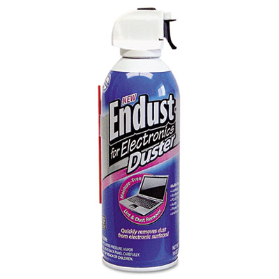

I'm wondering if anyone has experimented with endust or other anti-static products, or anything for that matter that helps prevent dirt/grease on CPU heatsinks.
Is something like this possible and/or a good idea?
Obviously placement is key (sometimes it's not enough), and some cases come with cleanable air filters... I'm just looking for more options.

ideal for DVRs Compressed Air in a can twice a year keeps it nice and clean
our dust down here laughs at those things
