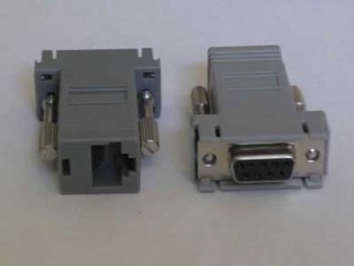

I'm using a self built avermedia 6480 32 channel NVR and want to capture 4 touch pro pos registers using the gerneric pole display outputs. I have the four Y adapters and a slew of the configure yourself db9 to rj45 connectors. I have done this many times before utlizing pin 5 & 3 and pin 5 & 2. I don't want to get super detailed as i know this is a public forum and this is my lively hood and I'm sure there are many of us here. I have tried all the combinations of null modem pinouts and and even a null modem adapter on all the variations . I have close to 30 hours into this anyone willing to help a fellow pro out? I have confirmed the dvr text insertion to be working this is definately a pin out issue. The most frustrating part is that i had one register up and running on the 1st test. I believe it was a lose connector that should have been unattached. I reseated all the connections and lost everything . I will get this figure out one way or another a life preserver sure would be nice about now.

There is a pole dislay present and I have also tried without the pole display by going direct into the pole display output port. I have done this many times. For some odd reason in isn't working on this linux based system. I have been on the phone several times with touch pro and they reassure me its and off the shelf pole display with default communication at 9600 baud. . As far as reliability I have yet to see one stop working in the 3 plus years I have been doing this so I'm not buying into that reliablity issue on this application. Yes there are some situations where a box is required box this shouldn't be one of them. Any ideas this is crazy? With a pc based system I could just create another output. There is no empty ports on the linux pos and I'm told a usb to serial adapter will not work as they have not written drivers for one. I can hook into the printer and get that info not problem but that is just about worthless as this is a bar/liquor store. Anyone else run into something like this. PS I had it working with a full 8 in null modem cable with a couple of pins not fully inserted on the rj 45 adapter. I'm going to probally end u modifying one so I can pull the pins back out till I get what i had. It was working perfect by accident .

I have a db9 serial port off the asus motherboardl that I'm using for testing. I have 2 models of mother boards I use for all my dvr builds so I know it works. 3 usb to serial convertors I have been using for years. I'm using a y cable at the pole display db9 port. Thanks for that web site I have tried every combo on there. Thank goodness the customer is really cool and he wants it to work even more than i do. Sometimes learning curves really suck.
At this point my case mounted nv-5000 with my 20 inch flat screen is about 3 ft from the pos register when testing. All said and done I will be about 100-150 ft from the dvr at the farest location. I'm using just the serial input on the mother board I have eliminated all variables. I can verify every thing is working by sending a printer test page from my laptop. l use usb to rs232 adatpters with the prolific chipset. They work flawless for me. I'm looking at breakout boxes as I type. Any one have suggestions as to what works best looks like they start at $40.00. It would be nice to tap in and see what activity is on each pin. Then I can be the total guru.

Yes all 4 of them are showing up on DVR. DVR will except generic test prints from a laptop on all 4 rj45 adaptors at register locations. Its a problem with interface at pole dislay. I dont understand it is so simple. Ground and signal I checked the pinout on the pole display db9 and even configured my connector to match with pins 7,8 and pins 1,4,6 tied together just like the pole dislay. Scratching my head.
Do away with the adapters and just wire them directly - pins 3 and 5 on the POS to pins 2 and 5 (respectively) on the DVR. The "sniffer" hookup from that link (with the diode and resistor) is probably a good idea rather than just parallel-splicing the wires.
Yes Tom rj45 to db9 self configured. I like the idea with the diode/resistor Soundy. Is there anyway that Im missing a connection here why is this not working???????? I'm just sniffing out the signal in this configuration.
soundy do you have a source for where i get these direct wire 9 pin female plugs? I found something with screw terminals but from china probally on the slow boat.
