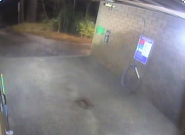

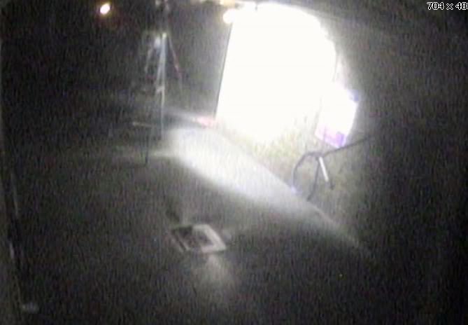

sequoia 0 Posted February 2, 2011 OK I have some pics. Not sure if I can upload them but I will try. The first set is primarily lit with a 96W compact fluorescent twin tube fixture. (There is a secondary fixture, identical, outside of the picture but not adding a great deal of light.) The second pic is a 28w LED fixture with a 20 degree spot focus. I was hoping to spot light the wall, signage, and equipment with enough light throw or light spillage elsewhere for the cams to work. NOT !! Share this post Link to post Share on other sites
cglaeser 0 Posted February 2, 2011 The first image was taken with daylight and the second images was taken at night. For a better comparison, take both images at night. Best, Christopher Share this post Link to post Share on other sites

sequoia 0 Posted February 2, 2011 If you are commenting on my images, they were taken about 5 minutes apart, both at night. A dusk to dawn light is great. But what happens when you have many of them, adding up to thousands of watts of them, burning 10+ hours, 365 days per year? The LED's start becoming attractive. Energy savings is one issue. So is bulb and ballast replacement. Share this post Link to post Share on other sites

sequoia 0 Posted February 2, 2011 I did neglect to mention that the landscaped area in the background of the brighter pic was lit with a 250w metal halide on the face of the building. I think this is what caused the confusion. So, although there was a dramatic change to the lighting in the foreground from the change from fluor to LED, there was also a change to the lighting in the background. I didn't think about the effect of that at the time. Had I considered that, I would have re-tested with the background lighting on so that both shots were equal except for the change in the foreground. But, given the results so far, I think the "spot focus" 20 deg LED would still be problematic. I have returned it now and have ordered replacement LED fixtures that have a 360 deg dispersal. I didn't really want ceiling fixtures, but considering camera performance I think I need to broaden out the LED focus as much as possible. Share this post Link to post Share on other sites
cglaeser 0 Posted February 2, 2011 sequoia said: I did neglect to mention that the landscaped area in the background of the brighter pic was lit with a 250w metal halide on the face of the building. I think this is what caused the confusion. So, although there was a dramatic change to the lighting in the foreground from the change from fluor to LED, there was also a change to the lighting in the background. I didn't think about the effect of that at the time. The camera is trying to determine the best exposure based on the lighting of the entire scene. If you change the lighting of a large area in the background, that can have significant impact on the selected exposure. If the background is darkened, it will likely compensate by increasing the exposure, thus overexposing the foreground even more. If you had done the testing with the same lighting in the background, the LED may have faired better in the comparison. That said, I agree with your decision to get a different throw. It's not the color of the light that is causing problems; it's the narrow beam vs omni. Best, Christopher Share this post Link to post Share on other sites
