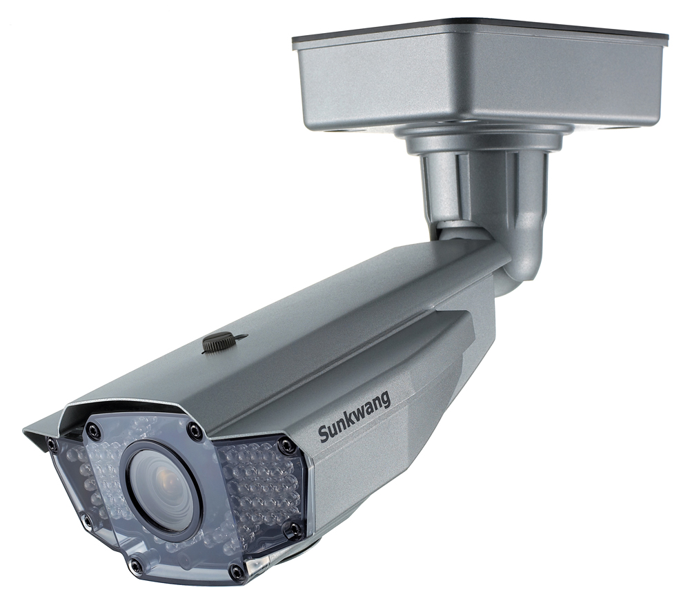

tomcctv 190 Posted February 7, 2011 others post ebay links. so i should think so . if you can see your gate from your house (15m) then yes it would be best installing the camera on your house looking over your gate. when looking for IR cameras remember to add the distance you need i.e 15m plus hight 5m = 20m so look for a camera with 25-30m IR range. one camera we did use last year we connected to a intercom system. it watched over the drive until the intercom button was pressed then it would zoom in to the intercom then 20s later it would return to watching the drive. Model SK-P700IRD/M844AI SK-P700IRD/M845AI Image Sensor 1/3" COLOR SONY SUPER HAD CCD II 1/3" COLOR SONY Vertical Double Density Interline CCD Pixel 410K Scanning System 2:1 Interlace Sync. Type Internal / External(Line-Lock) Resolution 600 TV-LINE(COLOR), 700 TV-LINE(B/W) S/N 52dB or More(AGC OFF) Video Output 1.0 Vp-p(Sync. Negative) Termination 75? Min. Illumination 0.01 Lux(F/1.2), 0.0003Lux(Sense up) 0.05 Lux(F/1.2), 0.0003Lux(Sense up) Gamma ?=0.45 typ.(0.45, 0.6, 1.0, user) OSD Yes(Multi Language) White Balance ATW(2,500°K~9,500°K)/MANUAL/AWC Shutter Speed 1/60(1/50)~1/100,000sec Sense up Auto(Selectable limit 2X~256X)/Fixed/Off Backlight BLC/LWDR/HLC/OFF BLC/WDR/HLC/OFF AGC LOW/MIDDLE/HIGH/OFF DNR(3D) LOW/MIDDLE/HIGH/OFF Motion Detection ON/OFF (240 Block) Privacy Zone ON/OFF (8 Zone) Mirror H/V/BOTH Freeze ON/OFF Day & Night ICR(AUTO, COLOR, B/W) LED Brightness 70pcs(LOW, MIDDLE, HIGH, OFF) DIS ON/OFF Digital Zoom ON(10X)/OFF Blemish Compensation AUTO/OFF Impact Detection LOW/MIDDLE/HIGH/OFF Communication RS-485(Protocol : Pelco D, Pelco P) Lens Vari-focal auto iris lens Power Supply 12V DC or 24V AC(Dual Voltage) Current Consumption MAX. 1.3A(at 12V DC, 24V AC) : LED ON Fan, Heater Yes Operation Temp. -20°C ~ 50°C Preservation Temp. -20°C ~ 60°C Dimension 141.9(W) X 80.2(H) X 183.3(D) mm Share this post Link to post Share on other sites

tops 0 Posted February 7, 2011 here are some item numbers on ebay: 390037997877 170598785261 320542988996 sorry urls didnt seem to stick on here..anyway search words I put in were - dvr night cctv - and I went for UK only. thing is, I am looking for something that receives images either on continuous record or motion detector and overwrites tape between around every 14-30 days, and has night vision. I think having it viewable online is useful if you are away, but it is not essential. Anyone tell me which is best one? oh yes, about the one you pictured, thats just a camera right? does it come with a system? so, inc fitting, how much do you think? Share this post Link to post Share on other sites
Numb-nuts 1 Posted February 7, 2011 Sorry to say this but not impressed by any of those at all. If you want a PC Based DVR then I would recommend Henry' CCTV a bit more expensive but the guys there are avery helpful if you get into difficulty installing or setting up. and look at one or more of this camera 380302839501 on ebay (a real bargain} with a varifocal lens. 600TVL and a good strong wall bracket No extra housing needed Better to have two great cameras than four lousy ones. Here is a link to some online videos (BY CCTV42) that will help you choose the features you want from a DVR and where to place your cameras for best effect They taught me a fair bit too when I started fitting my own cameras. Share this post Link to post Share on other sites
