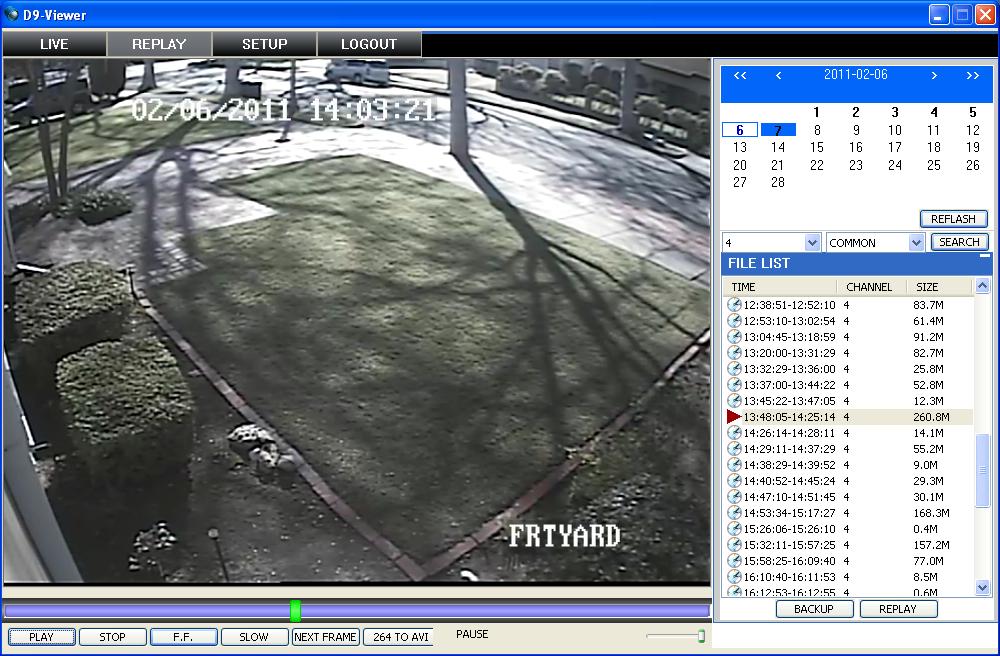

I was hoping to get some help out with a camera swap that I did. I have a 4 camera Q-See system and I'm really tempted to purchase a better new system after reading all the good info on this forum board. I was able to get this Honeywell HD70 dome camera (NIB) from a swap on Craigslist. I swapped out a bike rack that I wasn't using, so it didn't really cost me anything to have a new toy.
These are pictures from the dvr, not live.
Old Q-See 3.6mm bullet camera
New Honeywell HD70 4mm dome camera

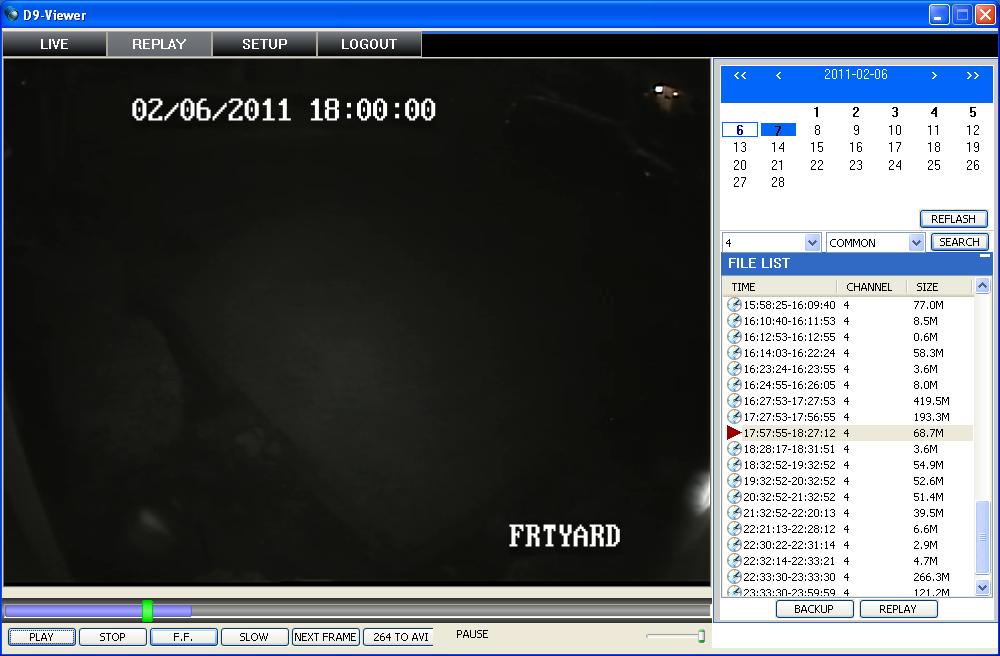

So I'm having some issues with the night picture on the Honeywell camera. It has 3 switches...
1) Flicker On/Off
2) AGC On/Off
3) BLC On/Off
Only thing ON is the AGC.

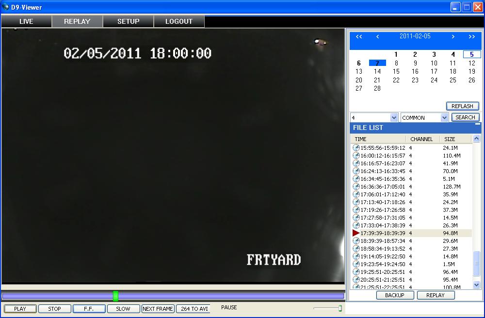

First shot before I realized that I had mistakenly taken out the foam ring, I thought it was shipping materials.
No foam ring, 6pm.
2nd day
6pm and with foam ring in! Not much better.
And this is with me messing with the brightness settings on the dvr itself. Still not great.
Can anyone tell me if maybe the settings are wrong? Should I turn off the AGC? Am I not being realistic to get a picture a little better than what the Q-See camera was providing me at night? There is some ambient lighting from the street.

The Honeywell is a definite improvement. Night-time quality is better, as well as day-time to some degree. Yea, the Q-See looks brighter at night, but look at all that grainy-ness! Maybe play with the BLC (Back Light Compensation), may be able to get a more uniformly lit daytime picture.

That Honeywell is just a Color IR Dome, dont expect too much from it. Was the Q-See a bullet camera? If so that could explain the extra Infrared - Say it with me, "Bullets are better" at least when it comes to built in Infrared (in general) AGC will make it brighter, but its not a real Day Night camera anyway. In the world of Color IR cameras, specs mean very little, but the actual difference between one and the next can be like night and day - it is just a gamble. That Q-See was definately a 1/4" though. Neither have an IR Cut filter. That 15m IR Distance would be 45' indoors, or in a closed in outdoor area. You could try adjusting the iris level if it has one on the board.

Probably wont say Iris and if anything would be the electronic iris level, just look for a small level that can be adjusted with a little Phillips screw driver . watch though as one of them might be for the power. Yes the camera will still switch to BW, basically kill the Chroma, its called Digital Day Night, and with no IR cut filter mechanism. Basically its rare to find a CCTV camera with a mechanical IR Cut filter and a fixed lens. Although I have seen at least one with the mechanism placed right above the chip even though it still used a Varifocal AI Lens, but most will have it built into the lens and part of the Auto Iris mechanism which makes it interchangeable between cameras.
Calling it a Day Night camera is a good marketing tool for sales, although it really IS a Day Night camera as it works in day and night, we typically call it a Color IR Camera (or Digital Day Night without IR) whether it switches to BW or not (some do not), and we call the one with the removable IR cut filter a True Day Night Camera, also can have "ICR" in its specs (Infrared Cut Removable). A True Day Night camera is normally a much better camera, more features in addition to the IR Cut Filter mechanism (coupled with the AI), and also typically longer range Infrared. Having the Infrared Cut filter go over the chip in the day time produces more realistic colors and an overall better image as it blocks out the IR from the Sun. Check my signature for examples.
