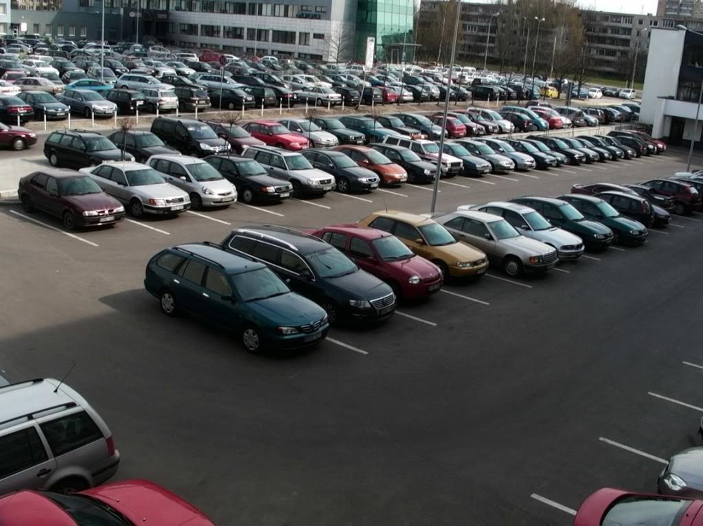

ak357 0 Posted February 10, 2011 (edited) I have done a couple small car dealerships.. Seems like the common problem the dealer wants to see the whole lot with four outside cameras... which is fine for an overview...but when an incident happens, you can make out any detail and the client is pissed. Any recommendations on the best way to design a system for a dealership, recommendations on a particular camera to use, placemement , number of cameras.. May be this will help you Pix from "Shropna" Edited February 11, 2011 by Guest Share this post Link to post Share on other sites

rory 0 Posted February 10, 2011 May be this will help you Thanks, any night shots Share this post Link to post Share on other sites
