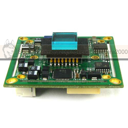

rory 0 Posted February 11, 2011 its the extra piece of square glass that is glued over the chip's glass. So remove the lens, remove the lens holder, then should be able to get at it. see it clear in this photo, that little aqua color thing on the very top. Share this post Link to post Share on other sites
florin 0 Posted February 11, 2011 "glass that is glued over the chip's glass" Glued? If I remove that, should I expect some messy glue needed to cleaned up from the sensor? If I have to glue it bak, what kind of glue should I use? I hope I can do it tomorrow night. Thanks, Florin Share this post Link to post Share on other sites
rory 0 Posted February 11, 2011 With the camera I did it to, it was more like some kind of putty, it came off. Otherwise could use Rubbing Alcohol to clean it up, but a really soft cloth like eye glass cleaners. In my case there was no way to access it easily, it was way down into the bullet camera, had to keep picking at it with a small screw driver, eventually I just ended up breaking the glass in pieces (by accident) and picked out the pieces I then used the small eye glass cleaner cloth on the end of the screw driver to push it down into the bullet camera housing and clean up the residue left over, dont recall having to use anything else. Share this post Link to post Share on other sites
