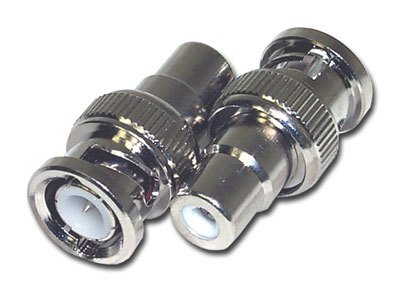

Soundy 1 Posted February 16, 2011 So anyway, Bruce.... short answer is, yes. Camera probably uses a BNC output, your VCR would use an RCA input, so you could use something like this with a standard RCA A/V cable: Share this post Link to post Share on other sites
