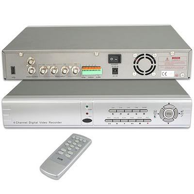

JNAPS 0 Posted February 17, 2011 Sorry if this is in the wrong section. I have a Standalone 4 channel DVR. I've had it for a couple of years and it's worked great. I think the hard drive took a dump on me. I can't record on it anymore. Every time I try it says something like there's no HDD to write to.. I have no idea what kind it is. I don't really see a name on it and I got it on ebay. Here is a picture of it below. My question is, can I just get a new hard drive and replace it, or do I need an operating system CD that has to be loaded into it? Please bare with me, I'm not the smartest french fry in the happy meal.. Thanks for your help. The HDD that's in it is a Maxtor Quick View Diamond max10 model 66080po 80Gig. Share this post Link to post Share on other sites
Securame 0 Posted February 17, 2011 You can replace the HD yourself, just check out what kind of HD it has, it will probably be a PATA hard drive (most drives today are SATA). Share this post Link to post Share on other sites
JNAPS 0 Posted February 17, 2011 I was looking at the FAQ's and just saw where Rory said that a standalone DVR's have an Embedded Operating System (on CHIP not on the HDD) and are generally non Windows. So I guess this is what I have? I can just swap out the DVR and it'll be ready to work? Where do I get this HD? In the US, Can I just go to Bestbuy and get one? I just put a new HD in my PC at home. First time doing that and I figured that out. Very easy.. Got that HD from Bestbuy.. Thanks for the info. Share this post Link to post Share on other sites

JNAPS 0 Posted February 18, 2011 (edited) SEANHAWG said: Go online and search for Seagate SV hard drives, those are the best for surveillance. Thanks for the info. I did look into them. I have another question, and sorry if it's an obvious one. Remember, I'm as dumb as a box of rocks when it comes to this stuff. The HD that's in it now is an 80Gig. I was able to let it record 24/7 on all 4 cameras at high resolution and it gave me about 3 days of recording before it re wrote. If I were to get a 500Gig, and ran the DVR exactly the same, will I get more recording days? I'm assuming it'll probably record just about a week and a half at the way I was using it before. Also, is a 500Gig HD a lot bigger? Will it even fit in this DVR that I have in the picture above? There is some room in there for a thicker one. I still gotta figure out if it's a PATA or an SATA HD. The one I have has the long, thin, flat gray wire and then a smaller wire plugged into it. I think it also said when I would reset to factory default that it was looking for the HDD and Master and Slave if that helps. I also remember the HD said it was from 2005.. Edited February 26, 2011 by Guest Share this post Link to post Share on other sites
Securame 0 Posted February 18, 2011 It is a PATA hard drive then. Share this post Link to post Share on other sites
SEANHAWG 1 Posted February 18, 2011 A 500gb is not really any different size than an 80 gig, maybe a little thicker but no significat size change because they must all fit in the same size bay. They are all standard 3.5" size. The difference between a sata and a pata is the connectors I think. Do a google search to see what the connectors look like and open up your DVR and match and compare. Some of the older DVR's that were made pre 2006 have connectors different than sata. But most of the DVR's today use sata drives. You will get alot more recording time out of a 500gig than an 80gig for sure. Share this post Link to post Share on other sites

tomcctv 190 Posted February 18, 2011 if your old drive is 80gig then it will be pata. so i would just go upto 160gig replacement. with a sata converstion kit and going to 1tb you will find your dvr will not see the HD Share this post Link to post Share on other sites
rory 0 Posted February 18, 2011 tomcctv said: if your old drive is 80gig then it will be pata. so i would just go upto 160gig replacement. with a sata converstion kit and going to 1tb you will find your dvr will not see the HD I still have plenty 80GB SATA drives in the field, including my own right here. Share this post Link to post Share on other sites

JNAPS 0 Posted February 25, 2011 OK, I went to my local Bestbuy and got the WD Blue 320G for $49.00 Put it in and so far it's working fine. Just thought I'd give you an update because I hate it when people ask for help and don't let anyone know how things turned out Thanks for all your help.. Share this post Link to post Share on other sites
