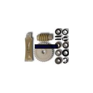

Birdman Adam 0 Posted February 19, 2011 Don't replace, repair!! These garage door systems are very repairable, generally built fairly well. -Could be that the starting capacitor on the motor is going bad, causing the motor to draw too much current. I believe they do have an over-current protection device built in (to sense when it is coming down on a kid). -Check for excessive friction in all joints and such, also look for any shavings! Slide the door by yourself to be sure its not the door/track. -As a side note, check the gears (mines a worm gear driving a normal gear connected to the belt), you are actually supposed to re-grease them every once in a while. Otherwise they run dry and hone each other out due to greatly increased friction. I had to install new gears because we had no idea! The kit came with a big tube of grease. Don't go spraying WD-40/Silicon/Lithium grease on the gears - they need the thick stuff the kit includes. Every year I open it up and re-apply the grease that has been pushed to the bottom/top of the drive gear back on them, this has really helped, and I see no wear accumulating. You can see the grease tube there, it can be bought separately if needed. -There are little contactors that are driven by the drive gear that tell the controller when the door is closed or open. Check that these operate properly and contact when they should. -Could the IR beams be moving when the door opens (causing it to stop)? The IR sensing should only affect door movement if the door is closing. Share this post Link to post Share on other sites
