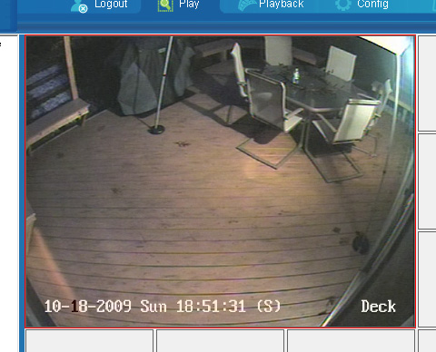

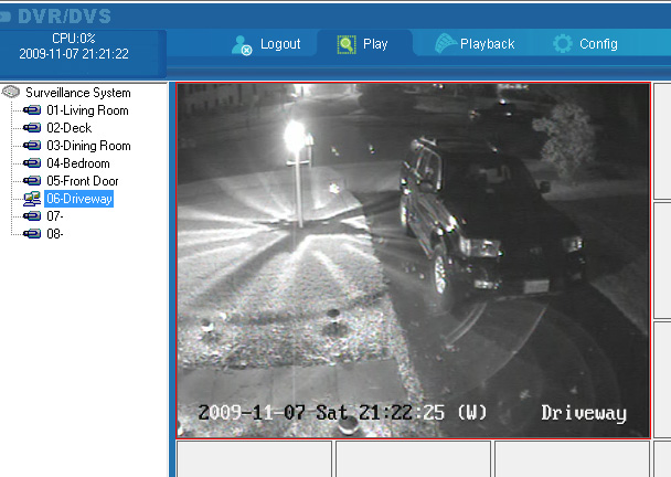

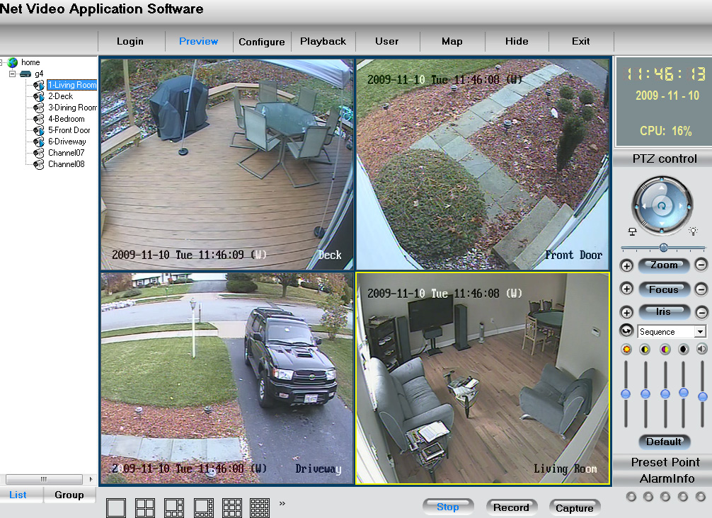

alpine0000 0 Posted February 26, 2011 thanks for the info/help just another stupid question: the smoke dome cover cause loss of image quality (night and day)? (PS. can I have a link to the TCM7811?) It won't cause loss of image quality, per say, but it will let less light into the lens, which is not really what you want at night time if you already have minimal lighting. During the daytime, though, there's no issue with the smoked cover. I have smoked covers on my domes, and here are some night shots. I do have some lighting outside though. So that helps a bit. The driveway shot is not great because I have a post light messing with the lens. I need to do something about that one of these days. But here is a daytime shot. All of the outdoor cams have smoked covers. Share this post Link to post Share on other sites
