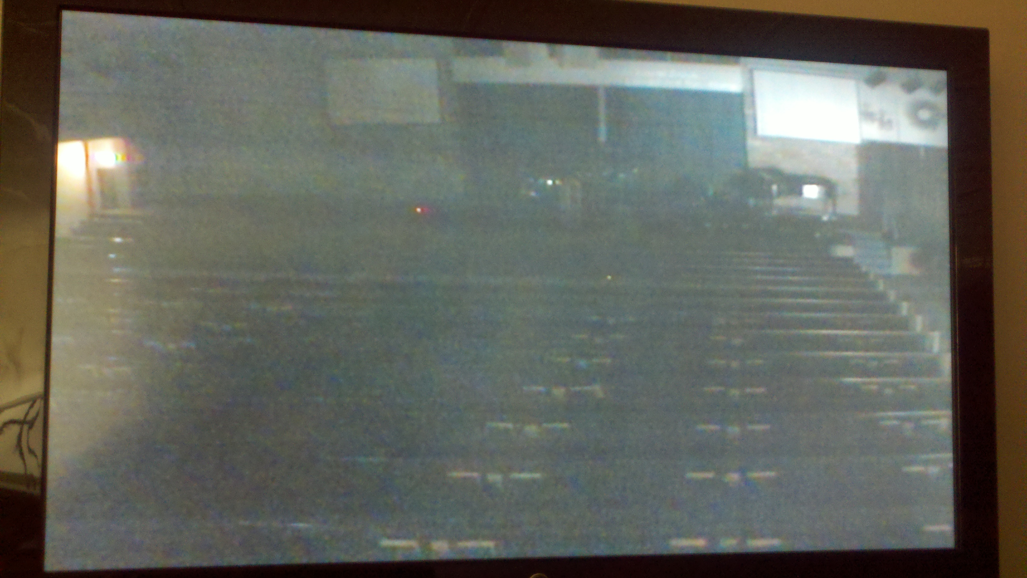

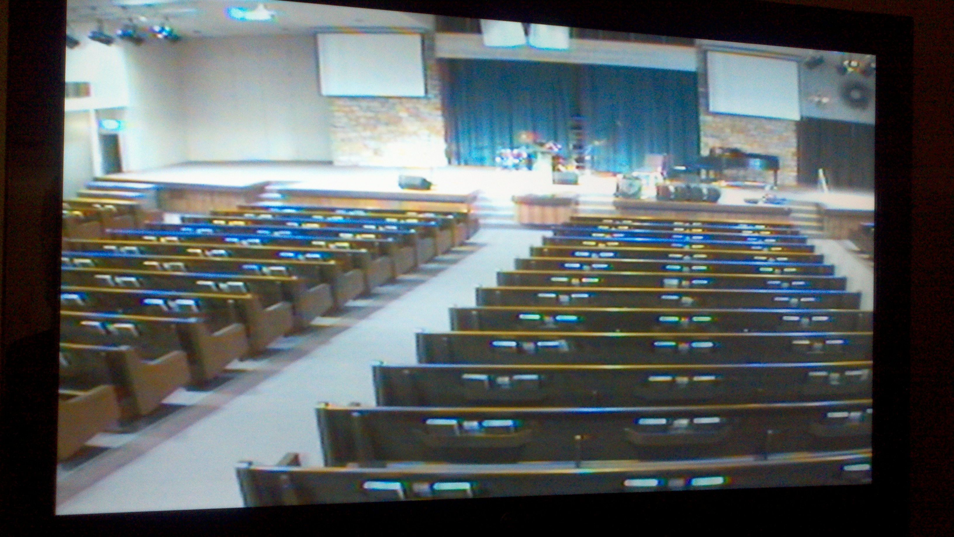

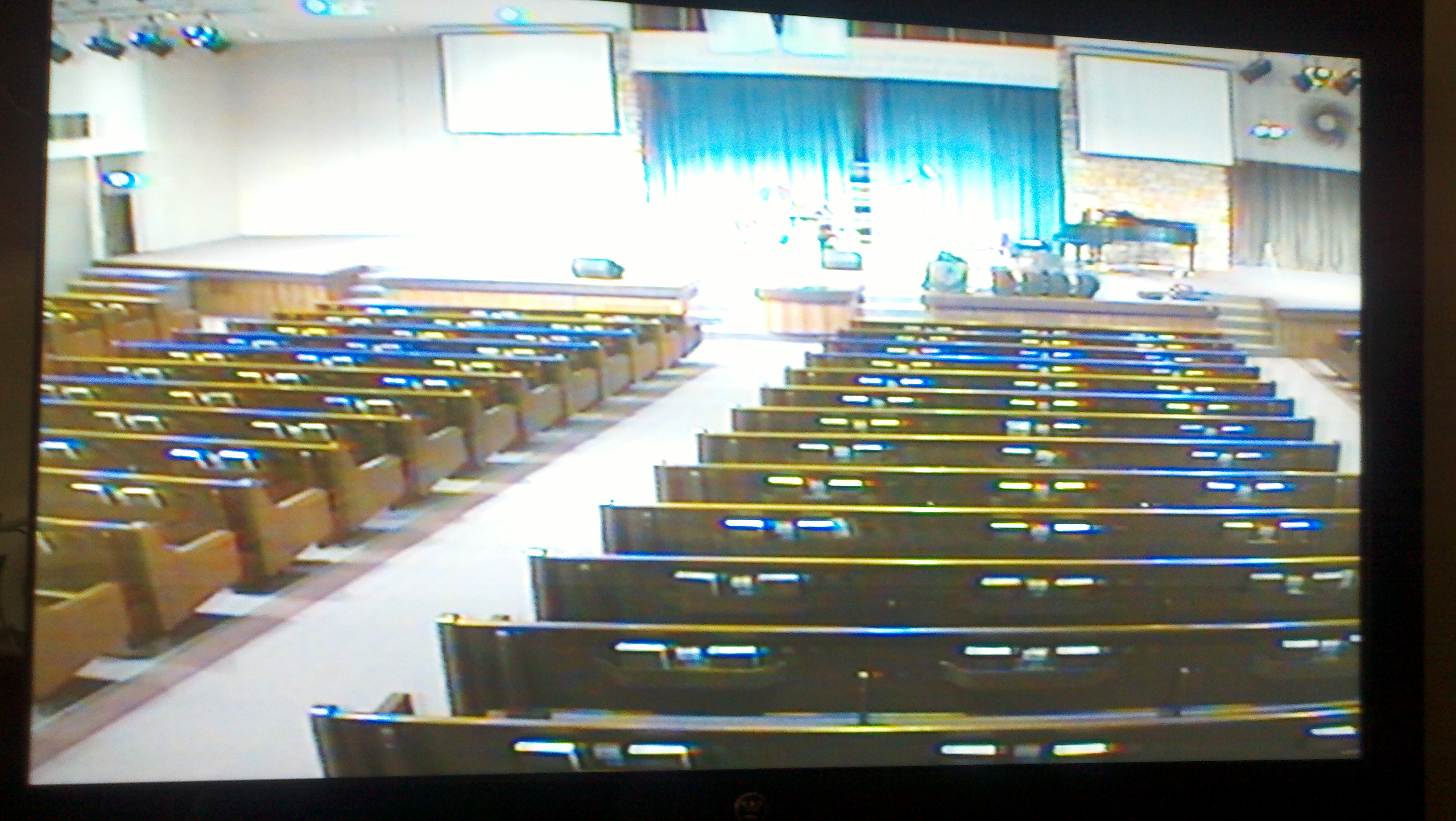

bcarusi 0 Posted March 1, 2011 Soundy said: It would be really helpful if you could post a couple of stills of the scene, both with and without the stage lights. Sorry it took so long, but here are a series of pics - In order they are no lights, house lights only (no stage), "Normal" stage lighting, and full on... With an empty stage it is kind of hard to tell, but when people are up there and you are at normal or full on you pretty much just see white blobs. Zooming in would probably solve some of the lighting issues but the camera is fixed zoom - BC Share this post Link to post Share on other sites
Soundy 1 Posted March 1, 2011 Yup, dynamic range is exactly your problem: the camera derives its exposure from looking at the entire scene, but most of the scene is actually fairly dark (the backs of the pews). Put a lot of people in there, especially in their "Sunday best" dark suits, and the camera isn't able to compensate. Zooming in would help... tilting the camera up a bit MIGHT help as well, although probably not enough. Something does does spot or even center-weighted metering would be even better, but those aren't common functions in analog CCTV cameras (some megapixel cameras, like IQEye, let you define exposure zones that would address the situation perfectly). Looks like this camera has probably 3.6 or 4mm lens... something like the CNB VBM-24VFs (if you want a dome) would probably work well, as they're auto-iris, have a really good dynamic-range function (not fully "WDR", but still good), and include a 2.8-10.5mm varifocal lens so you can get in tighter on the stage. CNB has other models that are WDR as well, but I don't use them, so I don't have any model numbers right off the top of my head. Share this post Link to post Share on other sites
