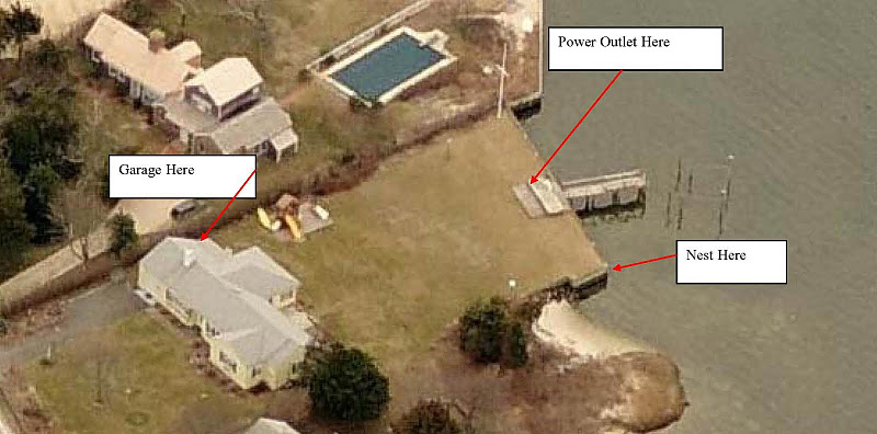

Here's the layout, I'll post a picture when i get into work tomorrow, the nest is along a bulkhead about 160 ft from the house, with nothing around it which is higher than it. About 60 ft down the bulkhead is an outlet.
To avoid the hassle of trenching the entire length of the back yard, i have decided to go with an IP camera utilizing a Powerline Ethernet setup to take advantage of the existing outlet, i may tap off that outlet and run an outlet to the nest pole itself.

Below is an aerial view of the yard i referred to in the OP.
