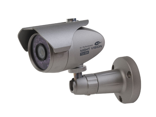

And modifying an existing fixed lens IR bullet would be difficult as most are like this:
Note the small size of the area where the lens is, a 2.5mm or 2.8mm would be too large.
The lens itself isnt rare and is cheap: Eg. first one on this page is a 2.45mm.
It looks the same size as the 3.6mm in the images but if you look at the thread you can see they shrunk the 2.45 mm image, it actually is much larger.

Eg: Approximate size comparison
