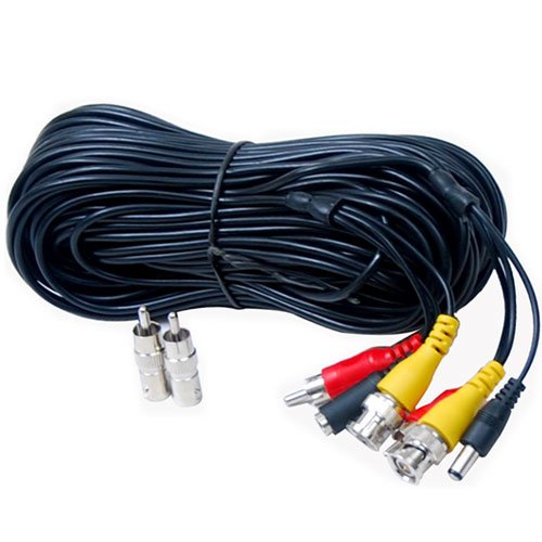

Ferrino 0 Posted March 28, 2011 Hi, I'm new to CCTV and am about to install a set of 4 analog Swann Pro-580 cameras (http://www.swann.com.au/s/products/view/?product=1169). My home has a wooden frame covered with stucco and I had a couple of questions I hoped you could help me with: 1. What's the best way to drill through the stucco from the outside? Is it basically a masonry drill bit, followed by a wood drill bit for the underlying sheet of wood? Are there are other layers of material to be aware of? On the inside I just have drywall. 2. The cameras have BNC and power connectors on their leads, which would obviously need to pass through the hole in the wall and require a hole of approx. 5/8" diameter for the BNC connector to pass through comfortably. I'd like to keep the hole much smaller than that, so would it be possible to chop the connectors off and crimp new ones on after feeding it through the wall? The diameter of the wire coming out of the camera is much smaller than RG-6 cable, so I'm not sure if a crimping tool would work on that small a cable (the ones I've seen appear to work with standard coax size cabling). This is the type of video/power cable that came supplied with the cameras: Many thanks for any suggestions! Share this post Link to post Share on other sites
bpzle 0 Posted March 28, 2011 I would strongly advise throwing that cable in the trash and using rg59 an 18/2 siamese OR cat5 w/ baluns. Those premade cables will degrade the quality of video, and pinch/ break very easily. Couple that with already having connectors on them... a total pain for fishing. Share this post Link to post Share on other sites
Soundy 1 Posted March 28, 2011 Masonry bit through the stucco... then wood or HSS bit the rest of the way. There SHOULDN'T normally be any metal in the way, other than maybe a wire mesh, but of course, nobody here can tell you exactly how the insides of your walls are constructed, because building codes and practices vary the world over (and change over time as well). You may find it preferable to first cut a larger hole from the inside at one camera location (somewhere hidden, like a closet or utility room), and pull out the insulation to inspect the inner wall structure. Be careful not to destroy the vapor barrier so you can tape it back up afterward. I wouldn't suggest chopping the wires - as you note, they're not standard size and standard crimps wouldn't work on them. Best best is to make a hole just large enough to fit the BNC through... push that all the way through, then the other connectors behind it, one at a time (you can tape them to the first wire). Share this post Link to post Share on other sites

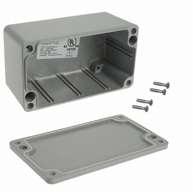

SDM Group 0 Posted March 28, 2011 You could put a junction box next to the camera for the connections, if its not too ugly Share this post Link to post Share on other sites

Ferrino 0 Posted March 29, 2011 Thanks again. I'm going to leave the BNC connector on the camera alone. Regarding the pictured cabling that came with the cameras, I'm not sure whether to get some better quality siamese cable or switch to CAT5e with baluns. I'm already starting to wire our network with CAT5e, so that would seem to make sense. Does CAt5e w/baluns offer good picture quality compared to high quality siamese cabling? Also, how do people typically package the balun on an outdoor camera (assuming it cannot be contained on the inside of the house)? Share this post Link to post Share on other sites
Soundy 1 Posted March 29, 2011 Regarding the pictured cabling that came with the cameras, I'm not sure whether to get some better quality siamese cable or switch to CAT5e with baluns. I'm already starting to wire our network with CAT5e, so that would seem to make sense. Saves you having to buy extra cable just for one purpose. Does CAt5e w/baluns offer good picture quality compared to high quality siamese cabling? Typically, you should see no difference in image quality. Also, how do people typically package the balun on an outdoor camera (assuming it cannot be contained on the inside of the house)? With the CNB VCM-24VF dome cameras we usually use, the balun fits nicely inside the back-box. With the cheapie bullets you're using, you'd probably want to use a weatherproof junction box, like this: Share this post Link to post Share on other sites
