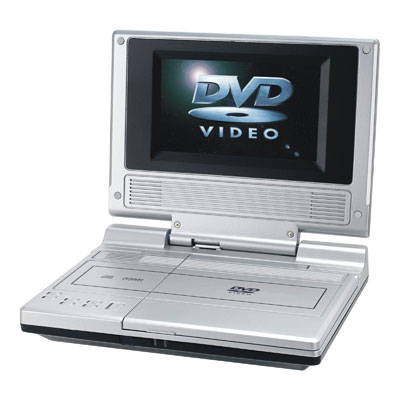

For an analog service monitor, I just use a portable DVD player with an A/V input - similar to this:
For IP cameras and remote access, I carry a netbook (Asus EEEPC model) - small, light, great on battery life, easy to read even in bright sunlight with an LED screen.
