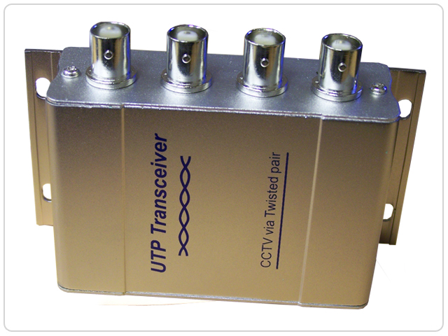

tomcctv 190 Posted April 12, 2011 Just been looking at these Cat5's - Can someone pls confirm if I am running 12 cameras & the power for these 12 camera's within the CAT cable how many CAT cables do I need? Thanks hi looking at were you have said you need cameras. 4 IR for the general kennel you need 1 cat5 run for cameras. if you dont have local power you will also need to run another cat5 for power. 5 IR camera's to cover particular kennels again you will need 3 runs. if you dont have local power. with wire left over to add cameras later. or use for audio 3 longer range IR camera's for gates - 35m if all in the same location two runs. (1 for cameras 1 for power) each cat5 with run 4 cameras 1 pair each. either using single baluns or 4 way baluns. single balun. 4 way balun Share this post Link to post Share on other sites
