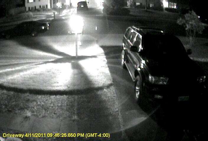

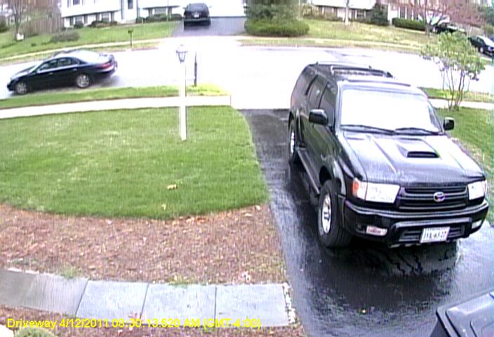

Just to give you an idea of what the scene looks like, here are 3 different screen shots of the camera it will be replacing (again, I know it is way out of focus again ). I also need to move that light and add some light behind the camera, because it seems to really blind the camera
Morning:
Afternoon:
Night time:
