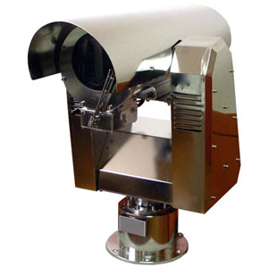

survtech 0 Posted April 23, 2011 The HZ20700R ?HZ20700RDC?HZ20700RAI might do. Its 700mm max zoom focal length would see an approximately 240-foot-wide swath at 5 miles with a 1/2" sensor. Of course, at that zoom level, the camera would have to be mounted with extreme care to prevent any movement. Even an infinitesimal movement of the camera would cause extreme "jitter" in the picture! You can also forget about any affordable pan/tilt mechanism for that amount of zoom - too much "slop" in off-the-shelf mechanisms. If cost is no object (and I know it is), you could use something like this: NB Security Systems PTZ-7000SS Stainless steel long range PTZ camera. * Custom built IP66 SUS316 stainless steel long range PTZ camera system. * Endless rotation and variable speed from 0,1° to 7° * Built-in RS485 Pelco D controller and high accuracy of Pan and Tilt * Multiple options, Auto focus, washer, wiper, heating ... "The PTZ-7000SS long range PTZ camera system is custom built to every customer, to meet the application specifications. The basic setup of the ptz system is built around very high level components like: Pan tilt: The IP66 pan tilt with built-in RS485 Pelco D controller is a heavy duty step motor pan tilt. The pan run 360° endless rotation with built-in sliprings to transfeer the signals. The pan/tilt has variable speed from 0,1° to 7° and a very high accuracy of pan and tilt. Housing: The very large IP66 housing made of stainless steel can house the largest motorized lenses up to 1500mm. The housing can be equipped with Wiper, Washer, Heater with fan, circulation fan and other options. Lens: The PTZ system can be ordered with 60X zoom 12,5-750mm with motorized 2X extender (25-1500mm), X55 zoom 10-550mm zoom with motorized 2X extender (20-1100mm), X50 zoom 20-1000mm or other large zoom lenses of your choice. Some lenses can run auto focus. Camera: The normally used camera is a very high sensitive 1/2" Exview ccd camera. For applications where extreme sensitivity is needed a EMCCD camera can be installed." http://www.2bsecurity.com/PTZ-7000SS-stainless-steel-long-range-ptz-camera.html Share this post Link to post Share on other sites

videotiger 0 Posted April 27, 2011 That stainless steel camera looks like it belongs in a kitchen Based on the view I'm getting with the existing bullet camera, which I set its varifocal lense to full-zoom (aka 9.5 mm), I suspect that I don't need anything more than 80 - 100 mm. The comment about a longer focal length lense requiring a rock-steady camera mount is something I didn't take into consideration. Thank you for all of the leads and suggestions. The search (and savings) goes on. Share this post Link to post Share on other sites
