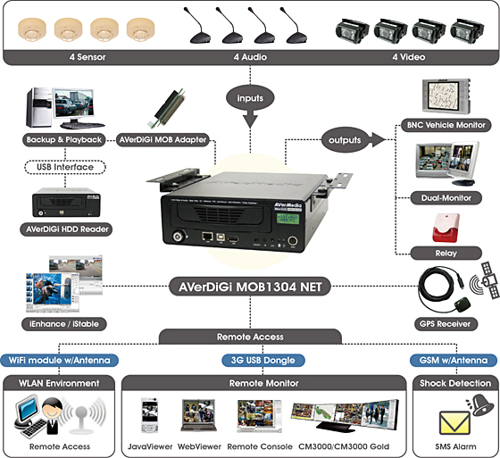

hi the new mob1304. will do what you need. you can now watch from your mobile phone
iStable software to fix shaking and jolts impact on video
Shockproof by rubber vibration insulator and brackets
Support 2.5" or 3.5" hot swappable HDD
Power circuit protection for peak voltage
7 Segment LED to display setting information and product status
Stable power supply for cameras and able to operate under low voltage
Provide 1 Video & I VGA output (CCTV+LCD)
Selectable function to operate the fan system automatically and stop HDD recording when overheated
2 years Warranty
Stable power supply for 4 cameras and able to operate under low voltage
GPS function – showing vehicle location and speed in both live and recorded video (GPS receiver required)
Dual-monitor function can be output as rear view monitor and general LCD or TV monitor simultaneously
The mob1304 manual states D1 records at max 15fps, can anyone confirm this, if thats so it wont meet my requirements.

it is 12.5 fps each channel on D1. what are your requirments. 12.5 or 15 fps is good. what are you going to be doing with it. ??

Thank you, so it wont fit my requirements of 25fps on each of 2ch's
Its for motor racing.
