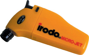

Numb-nuts 1 Posted April 24, 2011 When I install these Power plugs, at the camera end, although I enclose them in a IP66 junction box, I usually slip a short length of 10 mm heat-shrink (adhesive lined) over one of the plugs and after engaging the plugs, pull it back over the join, then shrink it to secure them. Great to have a handy butane gas heat torch, fits neatly in the pocket or tool pouch. Share this post Link to post Share on other sites
