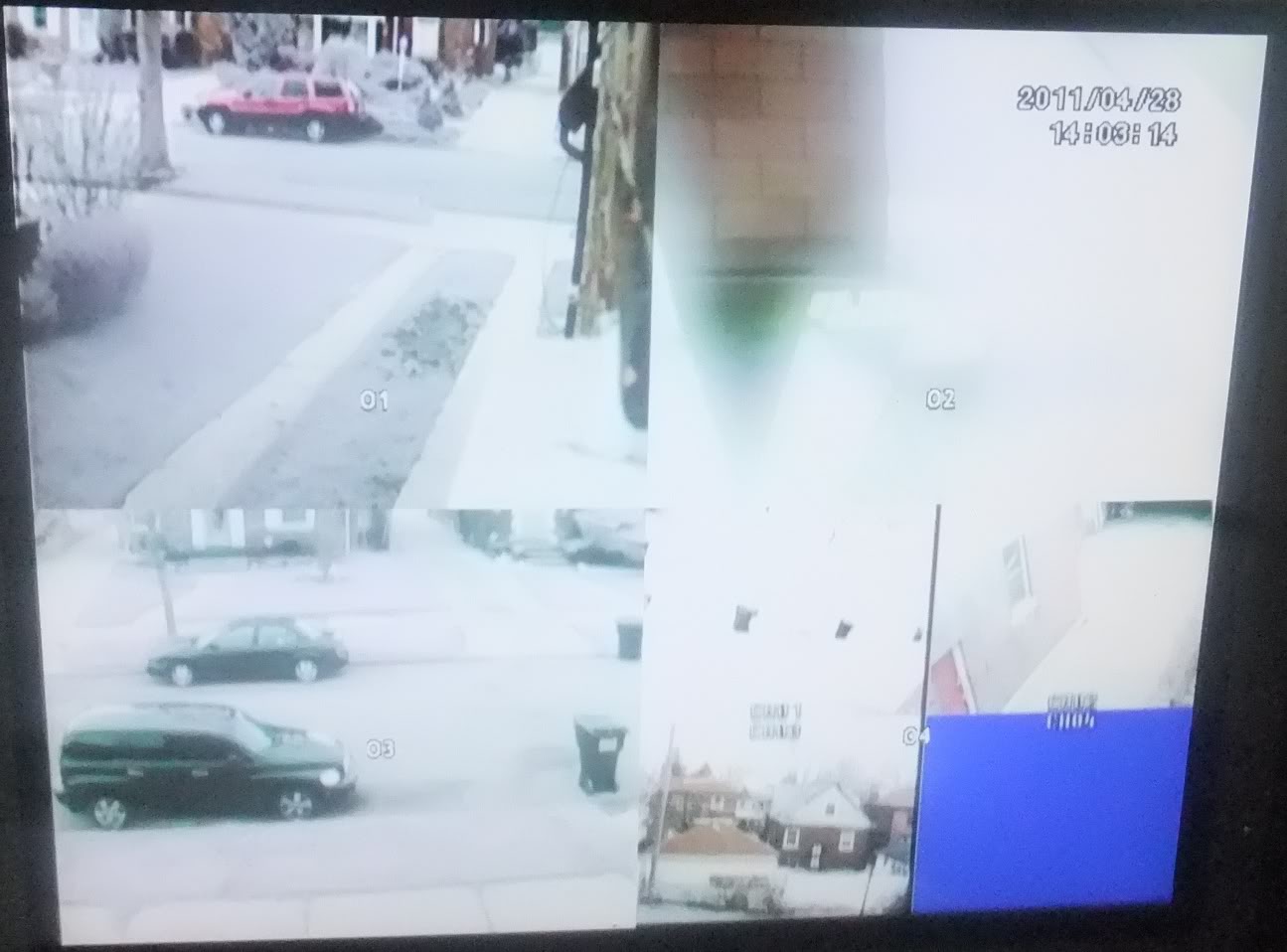

marquita188 0 Posted April 28, 2011 (edited) HELP! My CCTV Cameras Makes Grass/green color & coats/jackets/Black color look Purple in the daytime. how do i fix this without buying more expensive cameras? Edited April 29, 2011 by Guest Share this post Link to post Share on other sites

Birdman Adam 0 Posted April 29, 2011 There is nothing you can do. They have bad image sensors, coupled with no IR cut filter. That makes everything look off. Share this post Link to post Share on other sites

river324 0 Posted February 7, 2015 Hi All, I figured this out finally I had 3 cameras that are purple. I took one apart it had 4 screws in the back mine are zimodo brand I got the whole setup for about 150.00. after sliding out the camera I saw the the little red led I don't know what its for but its a IR sensor I think of some kind. I plugged in the camera and began to mess with, I found out right away if you cover that little red sensor with your finger tip the purple goes away. So what I did was put a little piece of black tape over it and put in back together and it works fine no more purple. I have no idea what that thing does but it seems to work fine now, go figure, hope this helps you all. Rick Share this post Link to post Share on other sites
