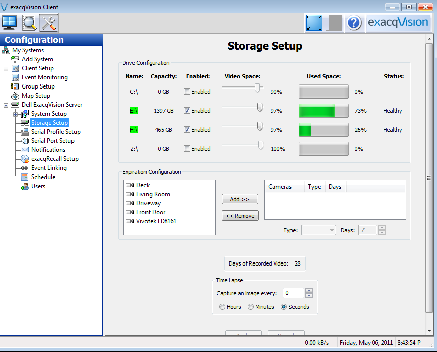

alpine0000 0 Posted May 6, 2011 i also agree that Exacq is the way to go. Granted, I only messed around with the trial version of Milestone a month or two ago before I decided to go with Exacq, so Im def not too experienced with Milestone, but I LOVE Exacq, and dont regret it. I also have the Axis 241Q in my system. I like that I can use the iOS app on my iphone or ipad, and i like that you can use *any* web browser. Its also very easy to setup, too. Right now I have 4 analog cams running through the Axis 241Q and then 1 IP cam plugged directly into my POE switch. I am going to slowly replace my analog cameras over the next year or so, and then just sell the 241Q here on the forum. I'm pretty sure if you spent the $750 on the Axis 241Q, you'd be able to get $450-500 back out of it when you sell it, and they seem to sell very easily around here A little teaser for you (click it for a larger image): Share this post Link to post Share on other sites

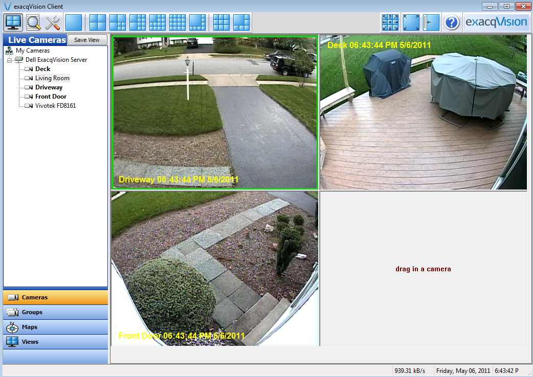

nyckylim 0 Posted May 7, 2011 A little teaser for you (click it for a larger image): Damm, those images sure look good for an analog camera. I think the 241q is easy to sell in this forum, however, I live in Singapore and there isn't a forum like this or any community that I'll be able to sell it off quickly. Therefore, I must really think and do through research before committing to the purchase. TWG: any idea when the new $50/channel vms would be coming up ? And how many fps does the 241q has in single mode? So I assume you guys mean that if for example in exacq I have a 4screen layout, with screen 1 as the acd200q (in quad mode), Screen 2,3,4 as ip cameras, in screen 1, the image will further be split into 4miniature screens? Lastly, as mentioned, should I partition my HD or just run vms, OS and recording data on same partition? Thank you all! Share this post Link to post Share on other sites
alpine0000 0 Posted May 7, 2011 (edited) I think the 241q is easy to sell in this forum, however, I live in Singapore and there isn't a forum like this or any community that I'll be able to sell it off quickly. Therefore, I must really think and do through research before committing to the purchase. Just because you live in singapore doesnt mean you cant sell it here on this forum... as long as you are willing to ship to the USA or some other country, it shouldnt be a big deal. Lastly, as mentioned, should I partition my HD or just run vms, OS and recording data on same partition? I think its best, if possible, to have more than 1 drive. Have a regular, small hard drive running your OS/software, and then have another large enterprise drive purely for video recording. Technically, one drive will work though. There is a nice, easy interface for you to setup your recording options. In my case, my C drive is for my software, my Z drive is my network file share, and the other two drives (E and F) are for exacq video recording. My C drive is a standard HDD, and the other three are enterprise drives: Edited May 7, 2011 by Guest Share this post Link to post Share on other sites

nyckylim 0 Posted May 7, 2011 I'll try to see if I can exchange the Hitachi Deckstar to a cheaper 500GB for the operating system and purchase another enterprise hard drive for recording. If I can't, I'll probably just partition the drive. alpine: thanks for the image. TWG: i've seen that data sheet before. However it only states Full Framerate at CIF and not D1. Could u verify before I purchase it ? Also, you were saying u have the 241q for sale, do u ship to Singapore? Thank you. Share this post Link to post Share on other sites

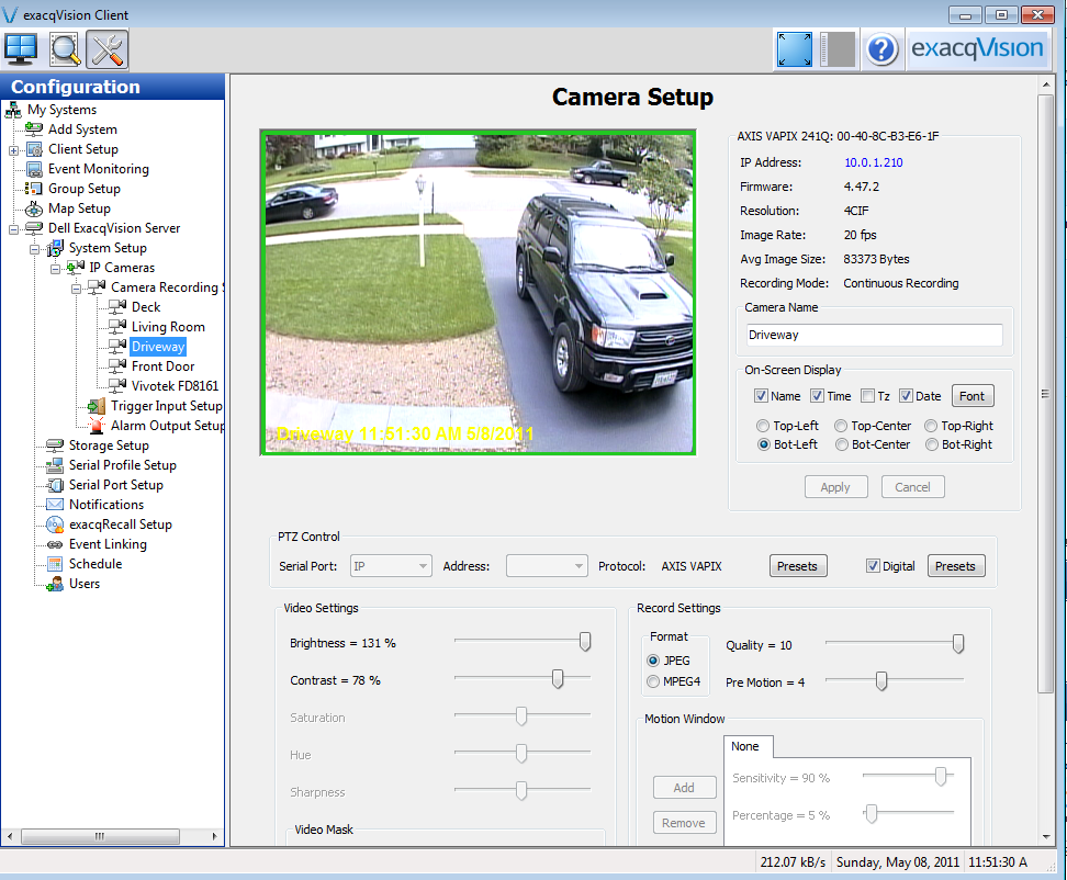

alpine0000 0 Posted May 8, 2011 (edited) TWG: i've seen that data sheet before. However it only states Full Framerate at CIF and not D1. Could u verify before I purchase it ? Also, you were saying u have the 241q for sale, do u ship to Singapore?. Alpine can you confirm frame rates with Exacq? . I am running 15fps on 3 of the analog cams in 4CIF, and 20fps on 1 cam. I havent tried to use any higher FPS. I will play with it when I get a chance and see if I can do 30FPS at 4CIF. I am using motion JPEG, btw, not MPEG4. See top right of this screenshot: Edited May 8, 2011 by Guest Share this post Link to post Share on other sites

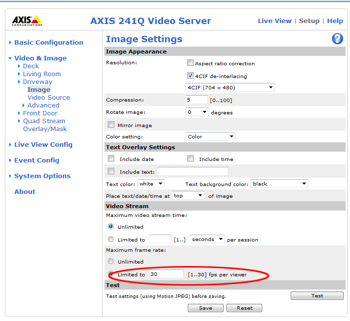

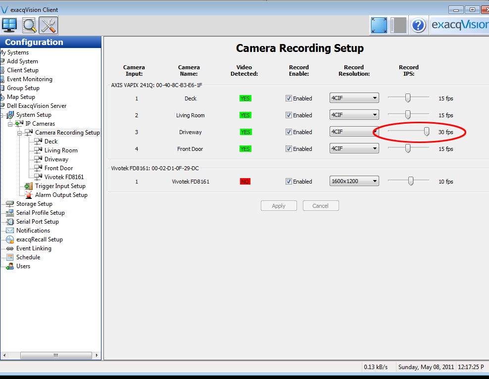

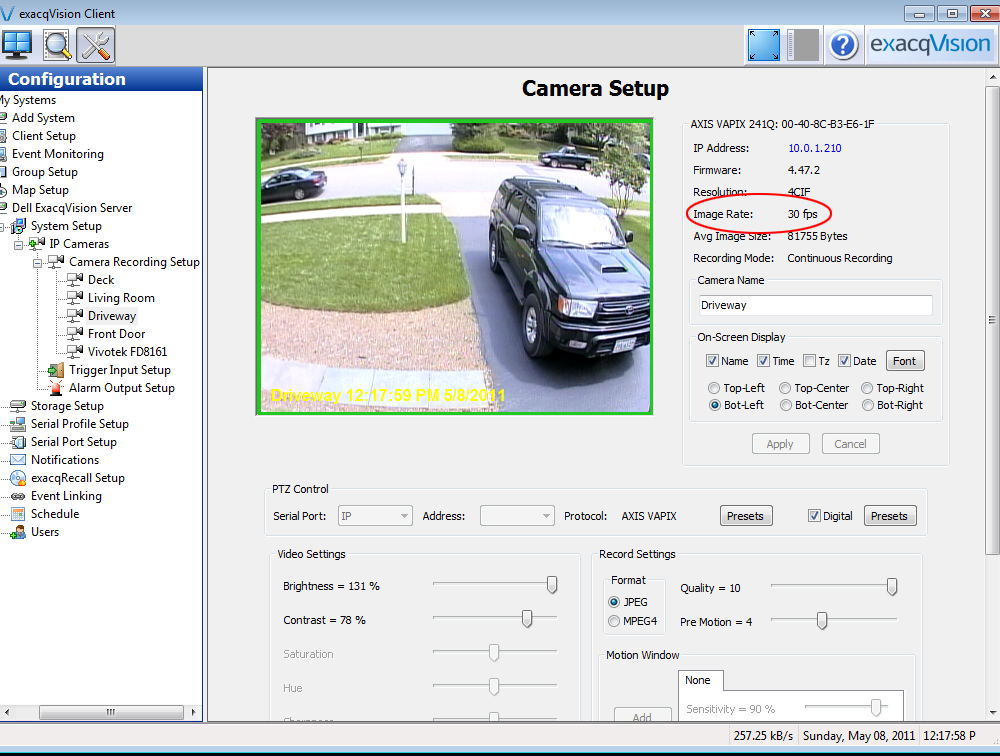

alpine0000 0 Posted May 8, 2011 (edited) Alpine can you confirm frame rates with Exacq? . Follow up: Looks like it will do 30fps using motion JPEG. Or maybe I have some lying eyes, I dont know... You can login to the AXIS 241Q via IE, and set up all of your stuff here. The interface lets you set the FPS anywhere from 1 to 30. Then in EXACQ you set your recording FPS here: And this page shows it as 30fps, too. So as far as I can tell, 30fps is possible at 4CIF using motion JPEG. I didnt do any tests using MPEG4. I dont have time right now, I have to get on top of some yardwark today Edited May 8, 2011 by Guest Share this post Link to post Share on other sites
