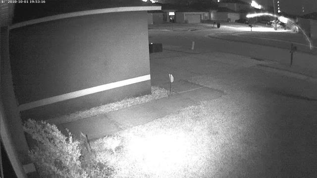

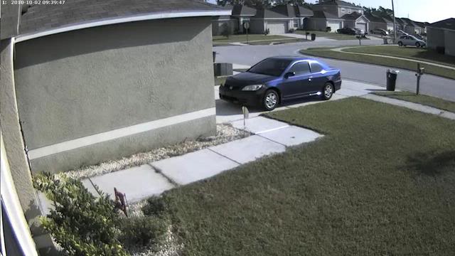

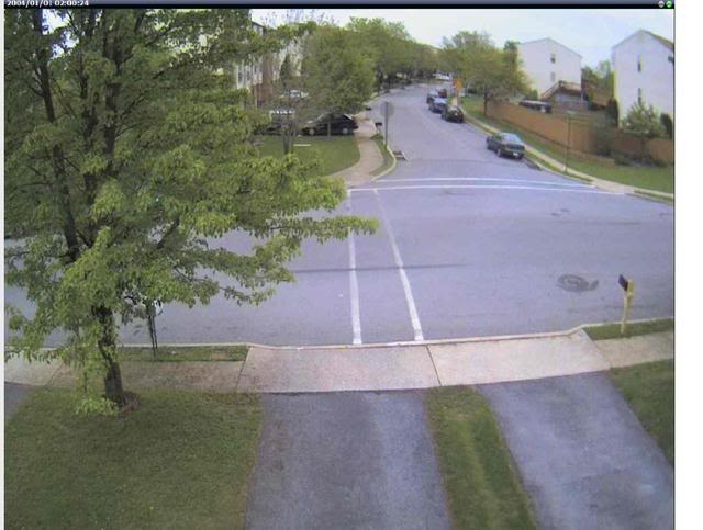

Rocket67 0 Posted May 7, 2011 Hi Nimrod, appreciate your reply. Was really talking in a more general sense eg which cameras and operating system - DVR or Computer Card to obtain images similar to the below photos - Photo by "The Wire Guys" on this Forum and these 2 photos from member Code4 on this forum - Hope it is OK to use the photos from this Forum. Please let me know if i should not use them, because i can delete them if required. To attempt to answer your questions - One outdoor camera in full sun for most of the day - no shade, quite dark at night, but have security lights. Another couple of outdoor cameras under porch and one in afternoon shade. Indoor cameras - probably dome type in 4 rooms. Reasonable face features required, but no need to go overboard. Lighting inside house during the daytime is average. Intend to buy a camera every couple of weeks as funds become available. Garage outside camera and also one inside the garage to start with - then build the system up as time and money permits. Do not want cheap and nasty. Expect each outdoor camera to cost maybe 4-500, and indoors around 2-300, but of course i will need to plan in advance and start with the correct operating system. Is this a bit better info? Thanks, Rocket. Share this post Link to post Share on other sites
Nimrod 0 Posted May 7, 2011 “Intend to buy a camera every couple of weeks as funds become available. Garage outside camera and also one inside the garage to start with - then build the system up as time and money permits. Do not want cheap and nasty. Expect each outdoor camera to cost maybe 4-500, and indoors around 2-300, but of course i will need to plan in advance and start with the correct operating system. Is this a bit better info?“ Much better info, you may be right about needing IP megapixel cameras for some of the views, i suspect 4 to $500 may be a little light for them but i am not the IP megapixel expert. Lets see what the experts say. Otherwise think about getting good quality analog cameras and putting them at choke points were you know they will have to come in, like gates or doors. Then you would not need the expensive megapixel cameras to cover such a wide areas. Possibly post pictures of your house and what you are trying to cover for the best feedback. Share this post Link to post Share on other sites

SEANHAWG 1 Posted May 13, 2011 Dahua DVR's are good DVR's but please note that you wont get the resolution anywhere near what the "Wireguys" posted with that type of system. Megapixel IP cameras and High Resolution Analog Cameras are 2 different animals. Even the high rez Effio-E cameras cannot compare to Megapixel cameras. Nothing wrong with Analog, but if you are expecting Megapixel quality, then you had better plan on Megapixel cameras. Why not contact the "Wireguys" directly and ask him some questions to determine what can fit in your budget to help you plan better. Share this post Link to post Share on other sites
