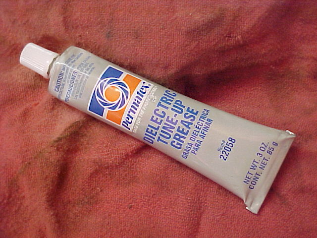

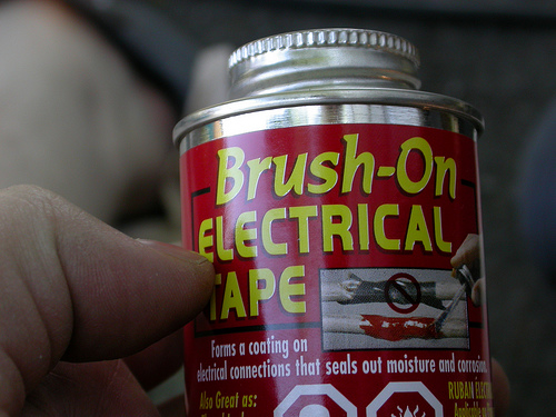

Soundy 1 Posted May 7, 2011 Ideally, run them into a waterproof box... short of that, I'd squeeze a little dielectric grease (often sold in auto-parts stores as "battery post grease" or "tune-up grease") into the connections (to keep water out and prevent corrosion), then seal them up with some REALLY TIGHT windings of quality PVC tape, or some heat-shrinkable PVC tape, or my personal favorite, "Brush-On Electrical Tape": Share this post Link to post Share on other sites

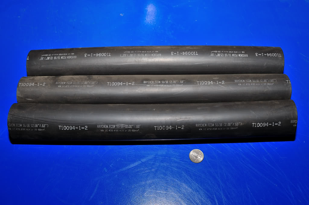

Tailbone215 0 Posted May 8, 2011 Only problem I've found with heat shrink is finding some that will fit over a BNC, and still shrink enough to seal against the coax. I figure you'd need at least a 3:1 for standard RG59... forget even trying with that thin pre-made stuff... or for that matter, the tails coming off most cameras. That's not a problem at all. I have a wide assortment of heat shrink tubing that has an ID or 2" and smaller. Here's stuff we used for 500MCM cable that has a native ID of 2" and can shrink down to 0.63". Raychem makes some killer tubing that performs well. I wouldn't use anything else for direct burial or underground junction boxes. Share this post Link to post Share on other sites
