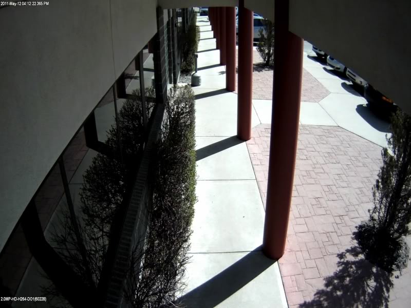

and just for fun pix for you done by Avigilon
size was reduce for forum

And thank you for the nice picture, i can not tell you how much fun i am having with it.
