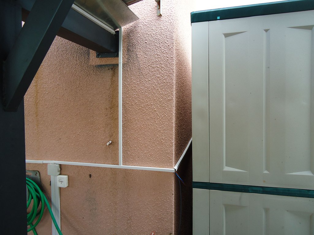

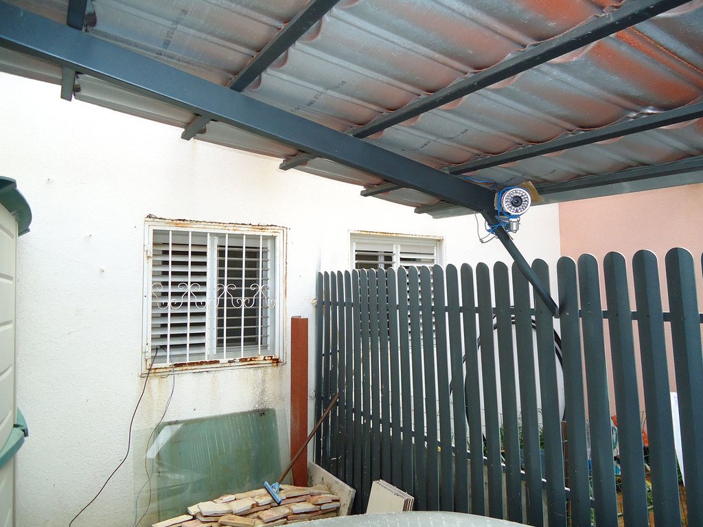

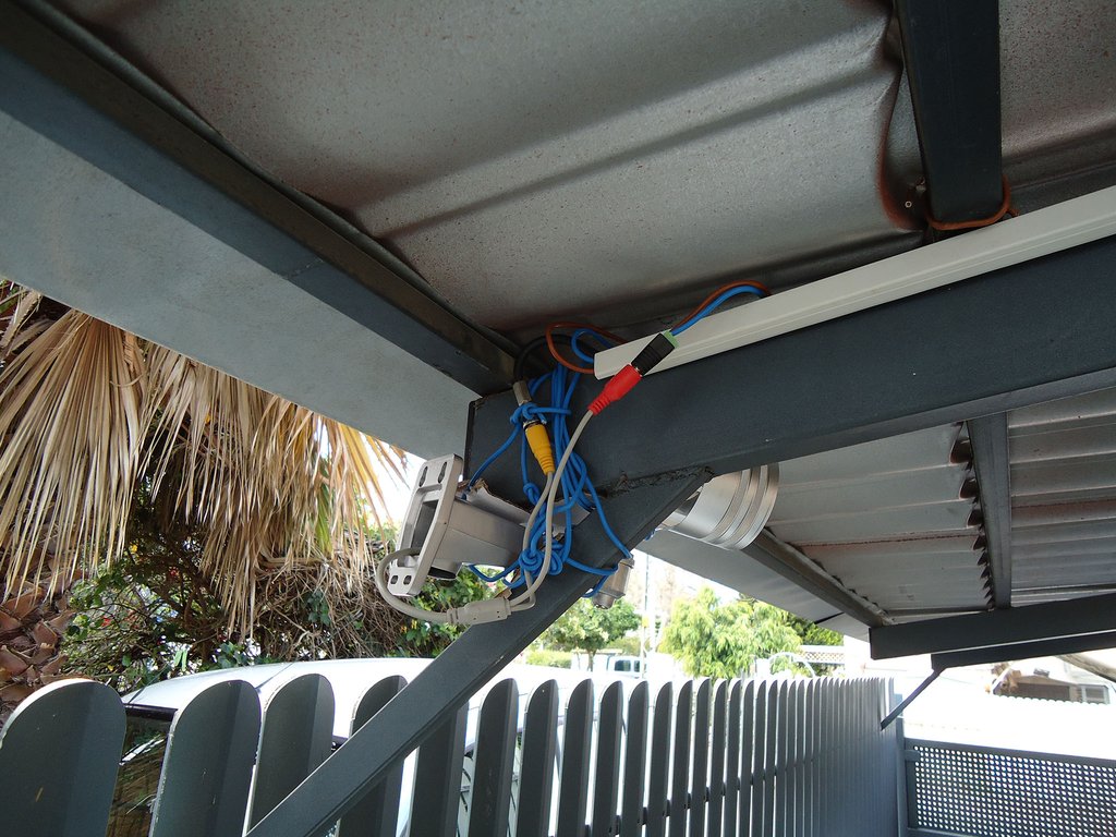

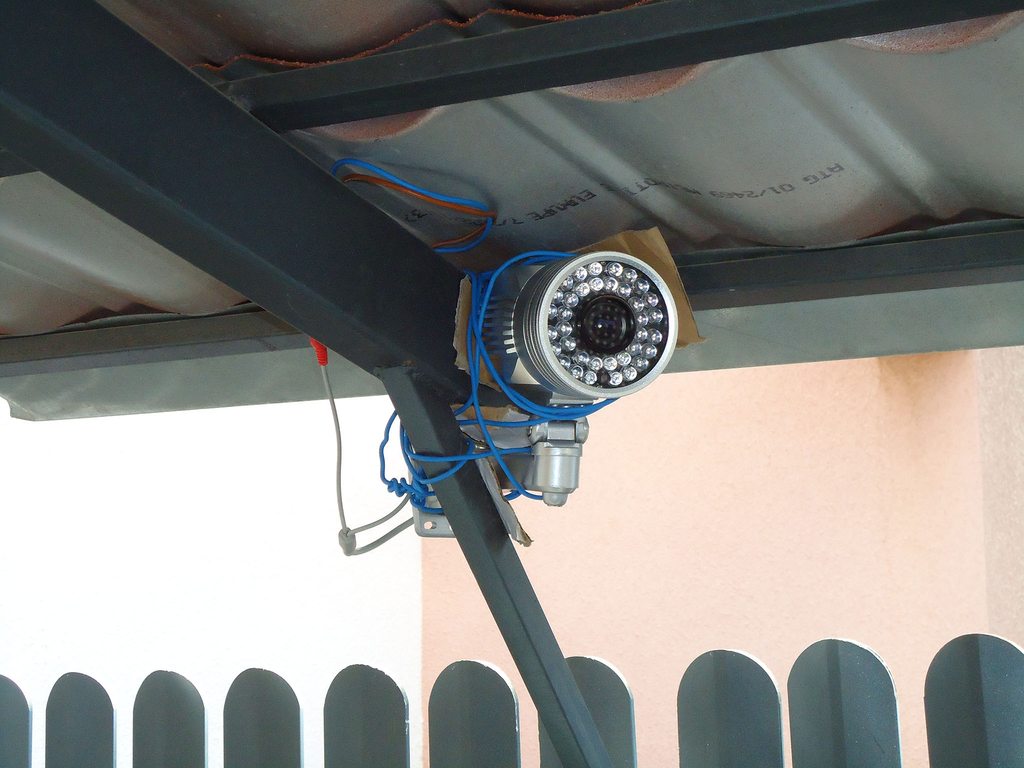

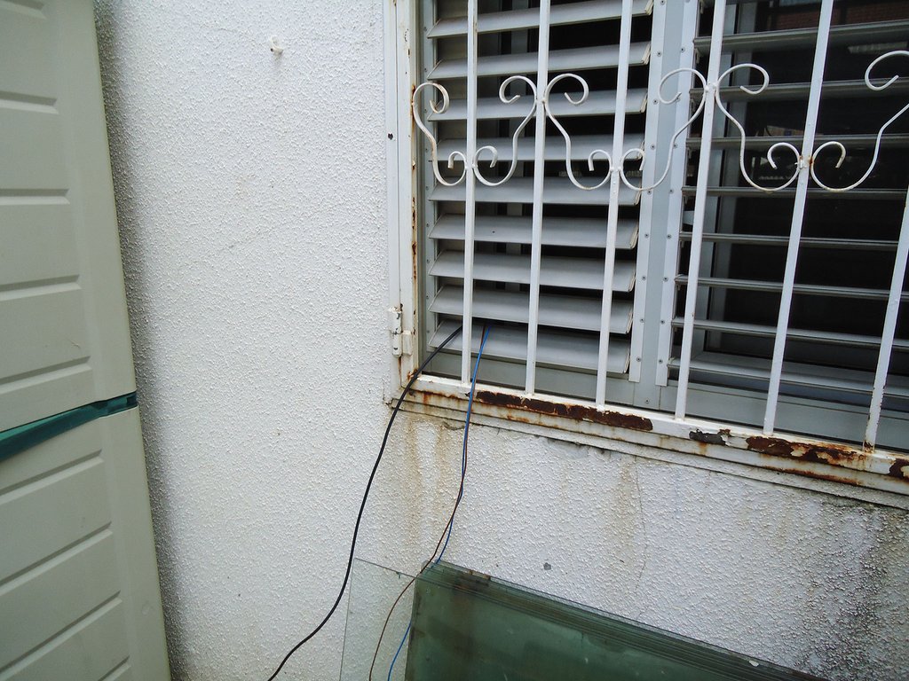

mastertheknife 0 Posted May 14, 2011 Here are pictures of the way the camera is currently mounted (click to zoom): The DVR is right after this window. mastertheknife Share this post Link to post Share on other sites

Campbell 0 Posted May 14, 2011 I know you were doing it on the cheap... but that mount job is making me cringe.. A LOT! Share this post Link to post Share on other sites

mastertheknife 0 Posted May 14, 2011 Campbell said: I know you were doing it on the cheap... but that mount job is making me cringe.. A LOT! Its pretty strong and long-lasting actually. Although at first i only considered it a temporarily solution, the other camera is mounted like that for about 1-2 years now without any removal or re-tightening. The cable is a ~12-14 gauge solid core and is hard to bend. mastertheknife Share this post Link to post Share on other sites

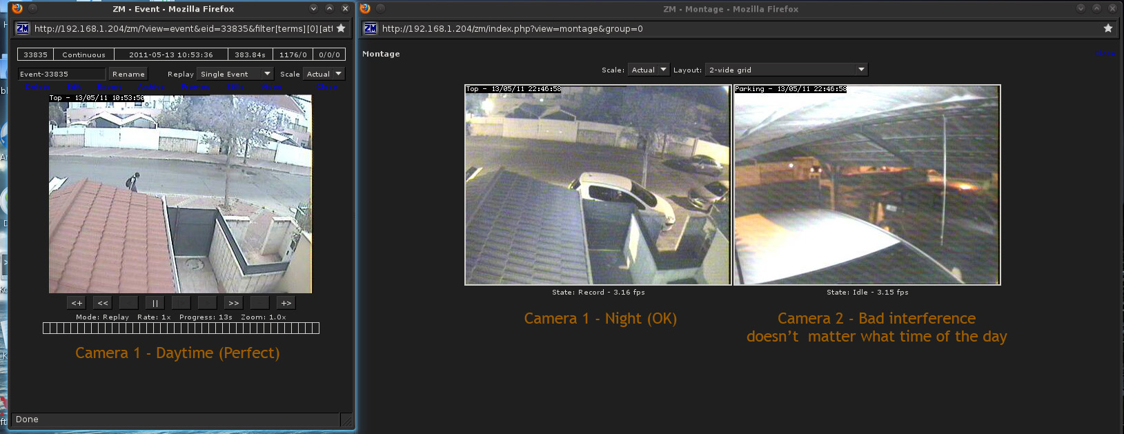

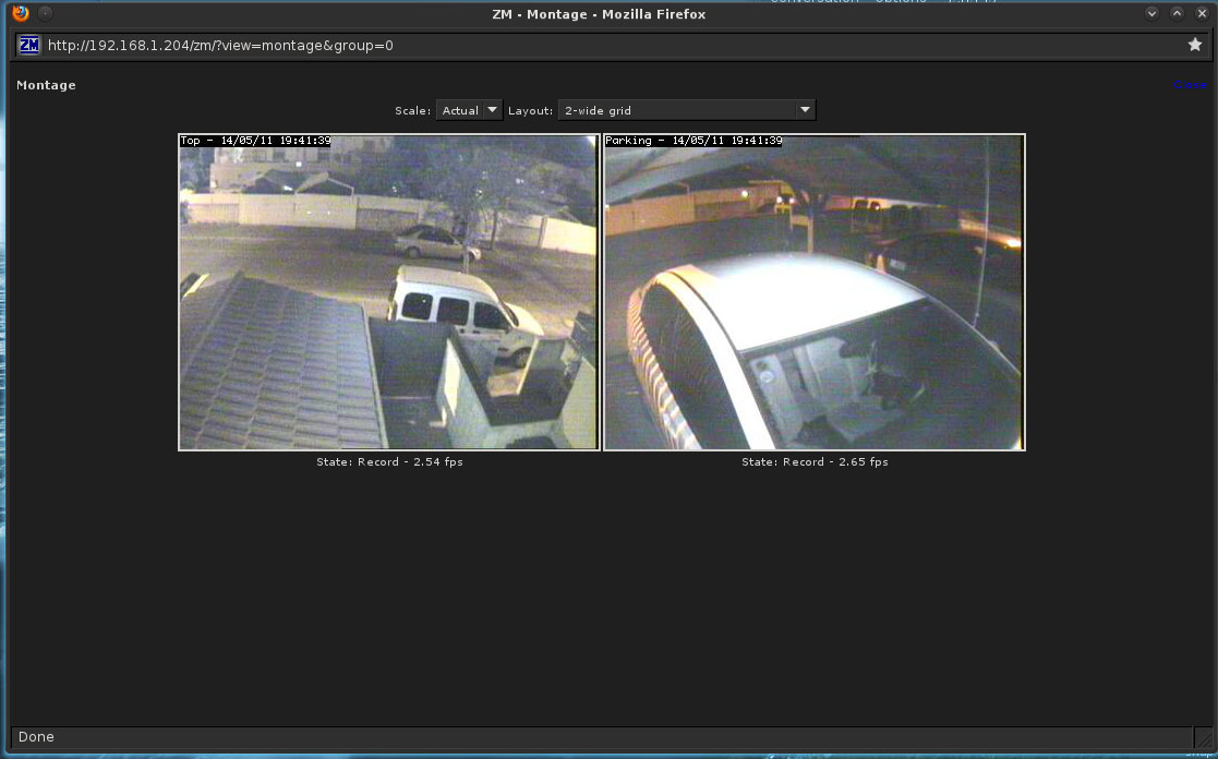

mastertheknife 0 Posted May 14, 2011 rory said: just spray it all the color of the fence and beam hehe. Need to replace the coax cable with new, attach a small plastic box behind the stand to make the connections inside (this way its weatherproof) and run a PVC between the box and the electrical duct Also, is a dome camera more suitable for this location? Its less visible and can be mounted nicely (with simple drilling to the top of the metal roof). Also, this is the image from the camera after relocating the cable out of the electrical duct. Looks similar to other (identical) camera. mastertheknife Share this post Link to post Share on other sites
Campbell 0 Posted May 15, 2011 mastertheknife said: Campbell said: I know you were doing it on the cheap... but that mount job is making me cringe.. A LOT! Its pretty strong and long-lasting actually. Although at first i only considered it a temporarily solution, the other camera is mounted like that for about 1-2 years now without any removal or re-tightening. The cable is a ~12-14 gauge solid core and is hard to bend. mastertheknife Oh I have no doubt it serves its purpose and does it well. But from an professional installing point of view... Share this post Link to post Share on other sites
Tailbone215 0 Posted May 15, 2011 Campbell said: Oh I have no doubt it serves its purpose and does it well. But from an professional installing point of view... I have to agree! There are an infinite amount of mounting possibilities in this situation to make a better install with less effort. Hell, a couple self tapping sheet metal screws work wonders. Share this post Link to post Share on other sites
