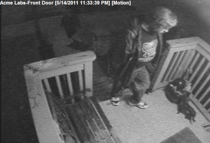

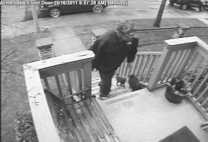

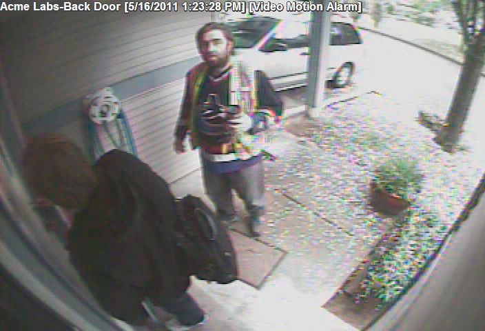

As an example of my front-and-back-door cameras, I have a Bosch B&W camera at my front door, and a CNB day/night camera at my back door, both set at about a 2.8mm lens length, giving close to a 90 degree field of view (forgive the poor image quality on the back door, I have a hacked-together wiring setup right now, using some of the existing Cat3 phone wiring in the house):
My son and I coming home this afternoon (door is on the left edge of the frame):
Coming in from walking the dogs this morning (door at bottom-right corner of the frame):
Both cameras are about 1-2 feet to one side of the door, and only a couple inches higher, mounted in the overhang soffit. They give a pretty good view of whoever is standing there.

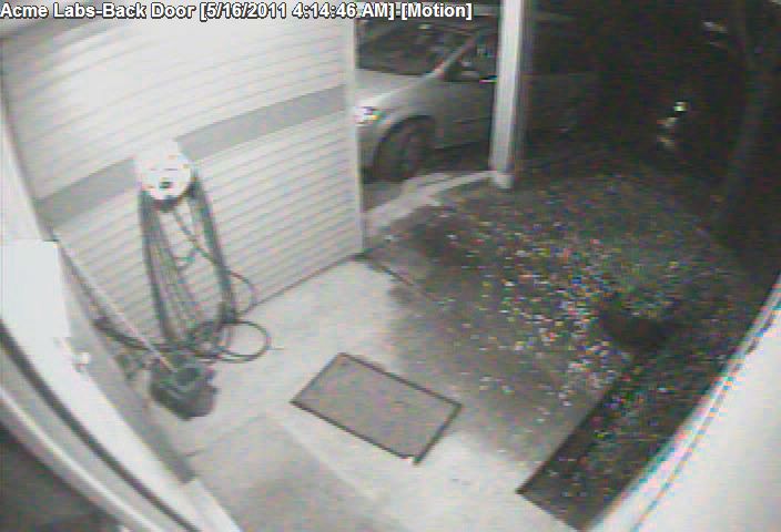

"Night vision" is a misnomer and really shouldn't be necessary - this is the back door with only a 13W CFL porch light:
