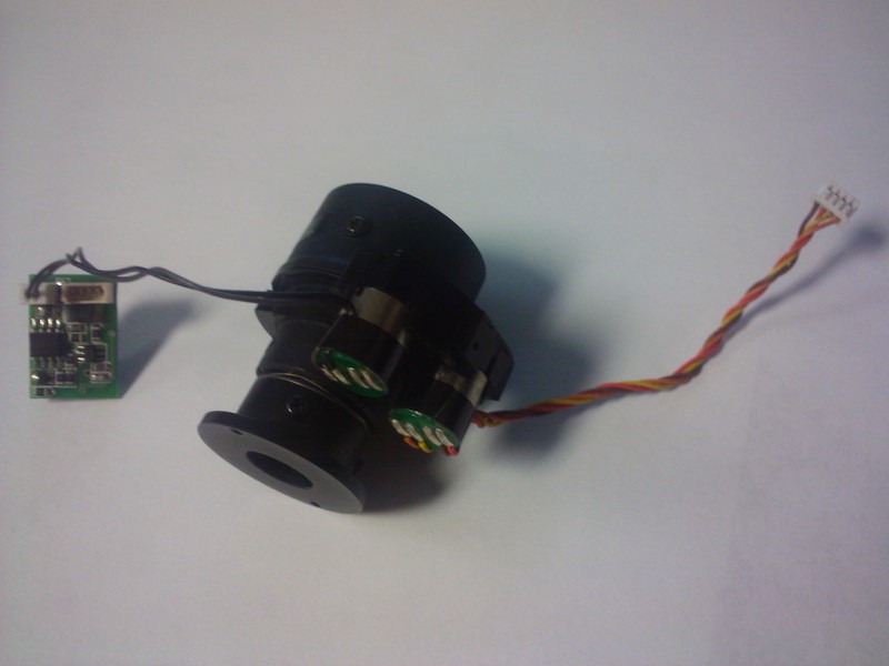

vin2install 0 Posted May 24, 2011 TDN is probably under a price revolution this year. The mechanical switch to move the IR-cut filter is down to $10 now http://www.dhgate.com/ir-cut-filter/r-ff8080812b51ebc8012b52d4943a0f0c.html#1 It's usually cheaper than that but that is only for box cameras. I have this one sitting here Uploaded with ImageShack.us This for bullets and domes. You can see how the AI and ICR are integrated on the lens itself. This is usually more expensive. Share this post Link to post Share on other sites
vibe 0 Posted May 25, 2011 Oh wow nice. Where can I buy those? I just bought a couple of box cameras just to get TDN ability, oh well. Share this post Link to post Share on other sites
