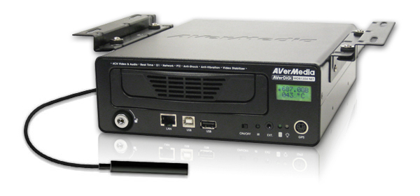

not a bad little unit this one. http://www.aver.com/Surveillance/Product/Detail.aspx?id=239

Not impressive at all:
* Using regular HDD at mobile system is a way to problems. Only storage with non-moving-parts are suitable for mobile applications
* Aver is using regular PC platform for its embedded mobile DVR, while truly mobile DVR should be based on cost effective DSP based chipset
* It just looks quite ugly, IMHO
What is the price for this unit? I hardly believe it can beat CVG-M even at price.

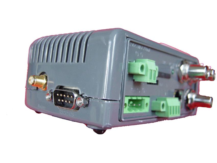

i have seen the CVG-M and one thing you dont do is buy on looks alone. but the CVG-m does look cheap . nothing fitts cant record anything as long as the avers. if we stuck that system in buses or police cars we would loose the contract. and just to point out HD mobile systems have been around much much longer than sd systems. so i cant see how you can say HD systems are a no no.
the CVG-M taken from there own website .......... looks like it has been run over by a bus

1. CVG-M is almost twice smaller than Aver. If you want to compare them by look, please, provide pictures at the same size factor.
2. Mobile DVR is not too much time are available on the market, so telling, that HD systems are presented longer at mobile DVR market is not very correct. Any IT specialist will tell you, that any DVR with moving parts like HDD or active cooling systems are not that suitable for vibrations and shocks that are definitely will be experienced at mobile applications.
3. As far as I understand, Aver Mobile DVR doesn't has build-in cellular modem and uses USB to connect cellular interface... well, from my experience, USB is not suitable for mobile applications and you should think about additional hadrware and enforcement to ensure USB will not detach during shocks and vibrations.
4. CVG-M looks very sexy! There are plenty of pictures of them available from different customers. Try to find such system and hold it at hand and you will understand. Moreover, we all know it well, how the device looks like is very much depends *who* and *how* has made those snapshoots. I can tell, that SerVision's folks more engineers, than photographaers (congratulations to Aver!)
