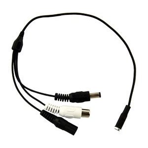

t3chsupp0rt 0 Posted May 27, 2011 That's a huge mic. Surely you can find smaller ones that perform just as good. Share this post Link to post Share on other sites
