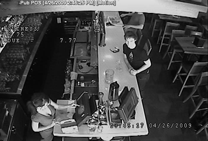

While I'm here, I would like to ask another question: I want to install one camera right above my POS system which keeps an eye on the screen and the cash going in and out. Is there a special camera or lens that I need for this application?
Not really... but capturing a POS screen this way can be really tricky, as reflections and varying lighting conditions can really hamper the readability, especially if the text is smaller.
A better idea is to look into POS interface systems - most modern POS terminals can output transaction information as plain text via a serial port, and many DVRs can then capture and log that information, or you can use a text-inserter box that will overlay the text on the video from the POS camera... looks something like this:
