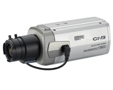

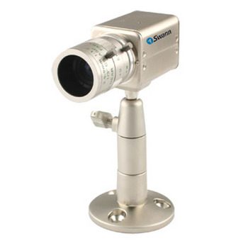

I currently have a cheapo Q-See PC Card QSPDVR04 that record 30fps shared among 4 video input, I believe. First thing first, would the DVR Card Geovision GV-800BNC going to make a difference? Next, I want to know which camera I should get. I have the Swann HD-420 with 3.5mm - 9mm zoom lens that could barely focus and I've been stalking the CNB BBM-24F camera with FUJINON YV10x5B-SA2L 5mm - 50mm Zoom Lens. What do you guys think of the upgrade?
Due to the environment I'm in, it's going to be indoor mounted but will be monitor through the windows. I need to be able to make out the face and not just a body figure that my camera captured below. Will the camera and the DVR Card do the job?

Thief captured using the Swann HD-420. Forward to 50 seconds on Youtube, or 10:39 on real time.

I haven't used this particular camera, but I definitely say YES to the 5-50mm lens. Zoom that thing way in - right around your bike. This way you'll have a wonderful identification, the face will take up 1/4 or more of the image. Keep in mind you should keep the framerate recording HIGH, because with this tight of a zoom, the subject won't be in the camera view for long.
Oh, and you will want the BBM-24F, you definitely don't need a WDR function for this cam. Monalisa chip is amazing!
I can only imagine your frustration...that is my fear...that I don't have something dialed in with all the effort and miss something.
You can pick up a used Bosch 5-50mm lens on ebay for around $10. The CNB will have good low light, but you may not notice a huge improvement in the picture for the money. If you want to go nuts I'd spend it on a cube Acti 4200 or some other megapixel (even though I had occasional artifacting issues and returned it). Depends if you want the low light.
Also if you use auto iris a lot of cameras default to the slowest shutter speed which may frustrate you zoomed in since it will move across the FOV quickly. Play around and do some testing to make sure you get the results you want. Good luck.
Ive used both, and the Monalisa Dome, I was not pleased with the BBM-24F. I would suggest if going for a box camera step up a little and buy a Bosch, Sanyo, Samsung, or Panasonic.
Otherwise I find the Monalisa Domes to be better quality than the BBM-24F.
For example one of my big issues with the BBM-24F is its inability to be properly backfocused, plus even with an expensive lens the picture is just not that great. I found the Blue-i Box WDR feature to be next to useless and that camera to be an even bigger waste of money, although its BLC feature is better than most - I also used a blue-i indoor dome and while the picture was not that bad, again the WDR was not worth using. Both Blue-i's I used were the more expensive double scan WDR.
BTW I used the BBM-24F along side 5+ year old Samsungs and although the BBM-24F far outperforms those in low light the old Samsungs were a much better image overall.
