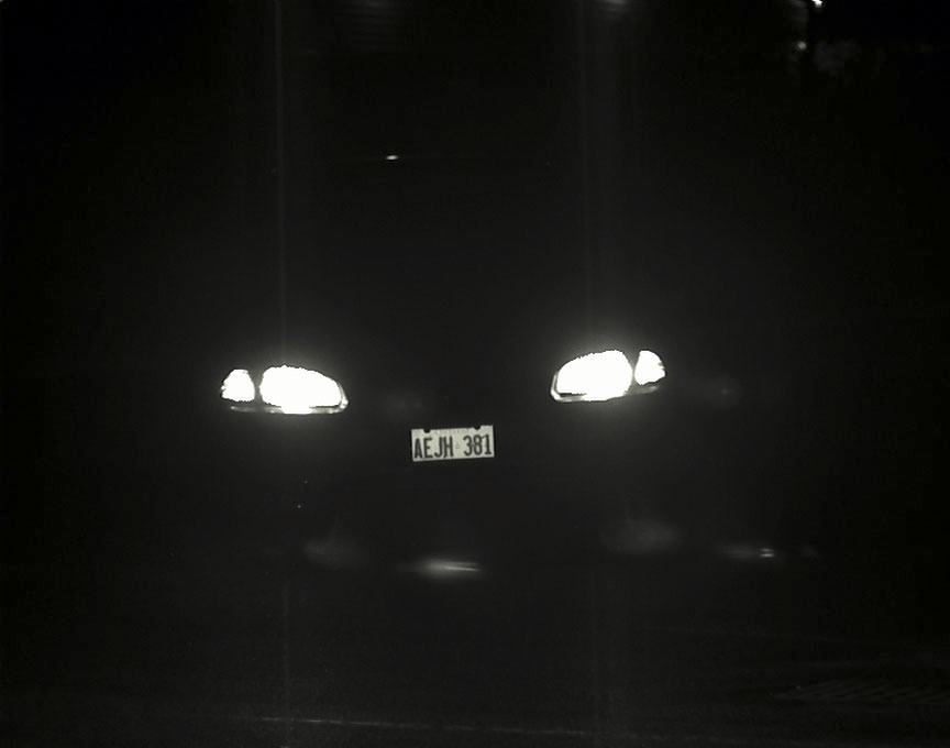

The second reason you'd use an LPR camera would be that the exposure wouldn't be relevant as your picture would be similar day or night (see below). The picture is incredibly dark and eliminates car headlights and glare flaring up and distorting the picture. The camera uses the integrated IR Illumination to reflect off the plate to allow the numbers to be a much higher contrast.

I'm well aware of the Lumenera LE165 product but wanted to simply state a point on how LPR should look.
Please post a picture of your night time footage to disprove my point, furthermore, please could you you post a picture of a vehicle at 50mph with your Axis camera. My emphasis was not on a brand (that was a suggestion).
