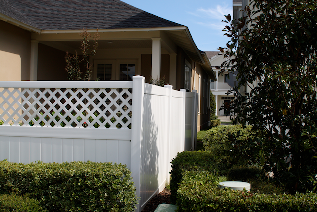

Here are some images of the area:

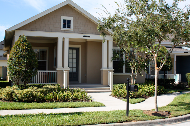

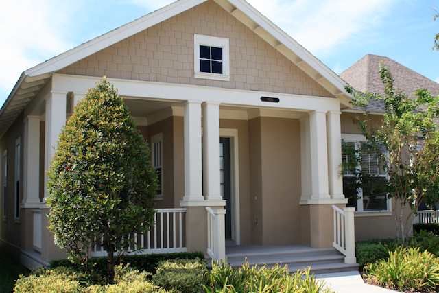

Front of property.
Front of property, showing the sidewalk area, taken from the street. As you can see there are three trees that can cause some issues.

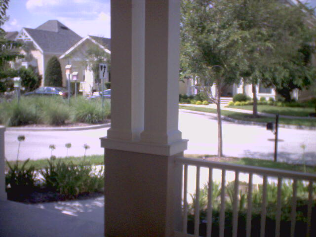

Current view I normally leave the front camera on.

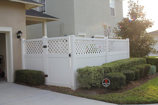

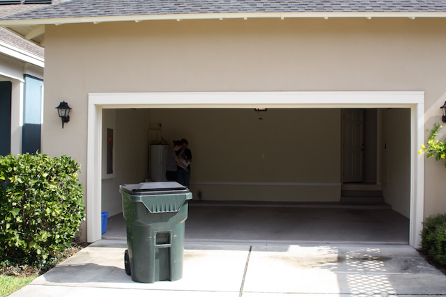

Rear Garage. Proposed camera location under eve on left side of garage, aimed over the driveway towards fence.
Rear Garage/Backyard. Proposed camera location under furthermost eve on right side of roofline, above porch area. Camera aimed over backyard/fence towards driveway.

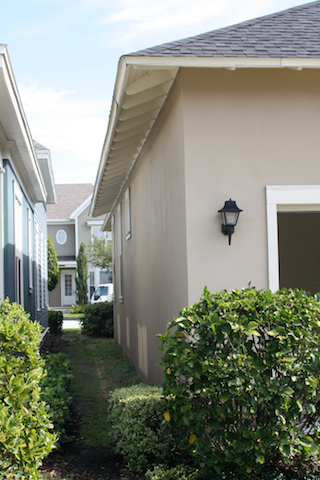

Another shot of the rear area, showing side yard as well.
Rear Garage showing opposite side yard.
For gear, I have been looking into a ACTi TCM-1231 or GeoVision MFD110 for under the eves. I also have been looking at used Axis Gear as well. I am open to recommendations, however this should give an idea on price range.
All will be run back to the structured wiring panel with Cat6, and will be connected to a POE switch.
Next door, our neighbor had a local installer put in an Axis 216FD above the porch, and elsewhere in the neighborhood a different installer put in an Axis M3204 in the same location. I find it interesting that both of these are mounted outside, however are indoor cameras. Experts correct me if I am wrong!
Thoughts would be appreciated. I am looking to acquire the gear within one month.

hi. many ggod cameras out there. axis/sanyo all well priced for home use. you said some of your neighbours already have axix installed. it may be a good idea to find out what software there are using and get the same (if good) you could then help and protect each other property. you take a camera stream from them and they take a stream from your cameras. good protection if one or the other has the PC stolen.

EOppie, here is my 2 cents worth of advice.
“Goal of the system is primarily for exterior monitoring/recording of home. There has been an increase in minor vandalism such as egging, irrigation system damage, trash/debris being thrown, and landscapes being damaged. Ideally I would like to be able to capture vehicles and persons that are in the area of the home during both daytime and nighttime hours. As far as ambient light at night, the neighborhood has streetlights, and my porch lights stay on all night.
I understand that for my budget, I am not going to go with a facial recognition or license plate caliber system.”
Think about this, you already have a camera system that does not identify, and you are going to upgrade to another system that will not identify?
“Currently I have been running Low End Panasonic IP Cameras, I have a BL-C1A in both the kitchen and living room.”
Hopefully you have these 640x480 cameras pointed at the entrance ways of the room were you can get an id if someone does break in. Also make sure you are not looking at an area of more than 5 to 6 feet wide for good id.
“For the exterior, I have a BL-C10A that is aimed out the front window. I am looking to upgrade this camera due to wanting better picture quality.”
Another 640x480 camera and out a window, i think you already figured out it gives a poor picture.
“For recording, I have a dedicated PC running Blue Iris which I have been happy with, however have been looking into other solutions based on this forum.”
Blue iris has a lot of functionality, its problem is the front end, or getting the picture in. I found that 640x480 ip cameras worked well with it, but when i went to a 1.2mp camera the cpu jumped up 20% with 1.8 gig duel core, and could only get around 4 fps max into it.
“Main concern once again is the front of the structure. I am currently debating camera locations, and I feel I may need to end up with multiple. Other homes of the same model have a single dome camera under the front porch, on the left side of the structure. This seems to work relatively well, I included a shot of what I can currently see from the window.”
If the other houses have gotten enough identification for a conviction. Then it may be a good model to follow.
“I am proposing putting a camera above the porch as others have done, as well as install another camera under the eve on the right hand side of the residence. I need to get up under the eve and look, as when the tree is in full bloom, I imagine this will be partially blocked.”
Tree’s can be a real problem and force you to use multiple cameras, or alternate locations. Some places you may not have considered assuming you are a hands on type of guy. Looking thru a hole in the fence, hiding camera in bushes or in some ornament that looks good next to bushes. Some people have made holes in garage walls for cameras.
“For gear, I have been looking into a ACTi TCM-1231 or GeoVision MFD110 for under the eves. I also have been looking at used Axis Gear as well. I am open to recommendations, however this should give an idea on price range.”
From what you listed the acti tcm 1231 looks best spec wise.
“All will be run back to the structured wiring panel with Cat6, and will be connected to a POE switch.”
Cat6 is not needed, cat5 will work fine. Use the one you have supplies for, wire and rj45 ends.
“Next door, our neighbor had a local installer put in an Axis 216FD above the porch, and elsewhere in the neighborhood a different installer put in an Axis M3204 in the same location. I find it interesting that both of these are mounted outside, however are indoor cameras. Experts correct me if I am wrong!”
You are right they are indoor cameras.
http://www.axis.com/files/datasheet/ds_216fd_combo_32272_en_0809_lo.pdf
http://www.axis.com/files/datasheet/ds_m32_41247_en_1011_lo.pdf
Putting aside the indoor camera mounted outside i would cozy up to the neighbor who has the Axis M3204, it is a 1mp camera similar in resolution to the acti you like, and you can and really study the its video to see if it can ident who is doing what.
BTW, this looks like a very nice neighborhood. From your description it sounds like many people are having problems. Do you have any idea why random acts of vandalism are happening there.
