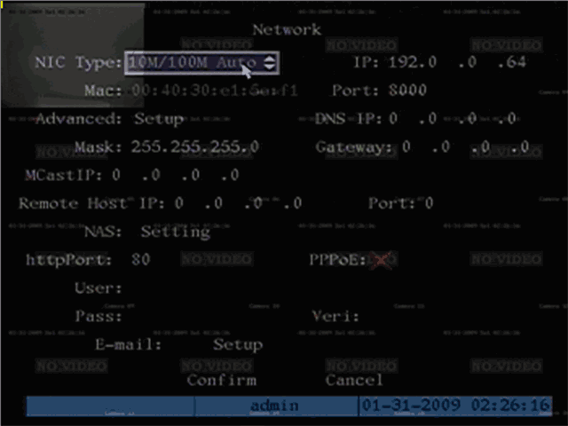

Check the following capture; those are the dafult values, httpPort:80 and Port:8000

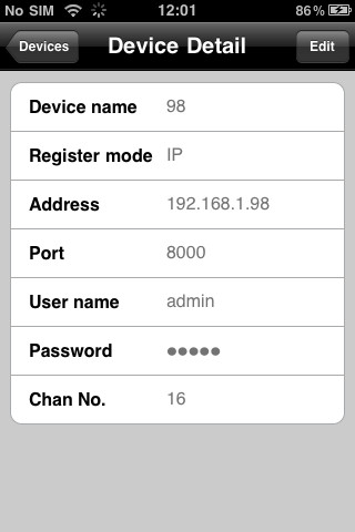

When you are using iVMS4500, you need to configure it with port 8000 (it will be 8000 already by default).
Keep in mind that on your internet router you will need to forward both ports (TCP/UDP) to your DVR network IP, I am sure that you have already done so with port 80 if you can connect to the DVR from internet.

I have already configured this in the same manner, same ports , 8000 and 80 for http, the IVMS 4500 always return the error " Realplay Fail:Net_DVR_ERROR:23"
