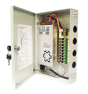

At the house where there are 7 cameras, I had planned on using a 9 channel power supply such as this
In the pool house with only 3 cameras, I was going to use a "brick" 12 volt 4 amp regulated power supply as used to power LCD Monitors. I typically pigtail out inline fuse holders so each camera has it's own fuse. Am I correct in this would be a Switching type ??
With as cheap as they are, I could easily install a 4 channel PS like the photo above instead.
