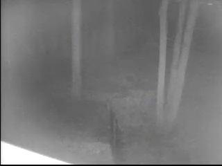

I am having a ghost circle around images with night vision. Im not sure if its interference on the cabling in my attic or something else.
Anyone else experience this?
Any suggestions are appreciated.
Also i have swapped cameras and it is still the same so should i assume it is cabling?
It's the IR light, reflecting on the inside of the dome or camera glass. It's a common problem with cheap IR cameras.
I agree sir,
See if you can get some form of gasket material, rubber hose, or foam tube that would fit around the base of the lense, and fit snug up to the dome. Basically you want something to shield the lens from the IR light...
