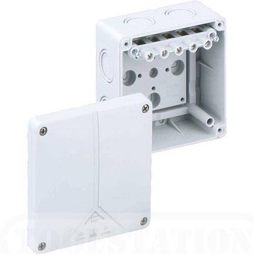

A typical IP65 rated box ( Please note IP rating has nothing to do with IP Cameras)
PS This brand of box is my favourite and in the UK I get them from Toolstaion who have a huge range of these and at a trade price.
