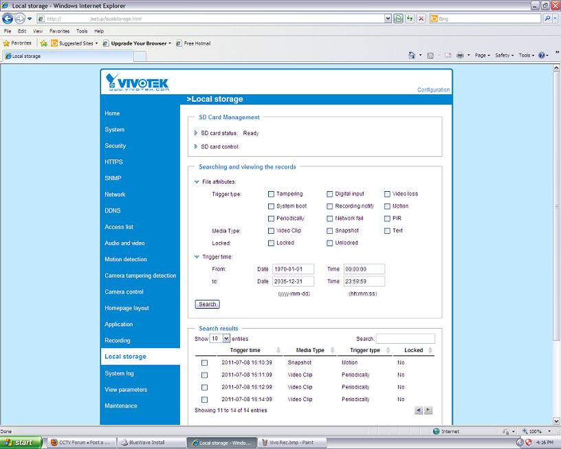

I am trying to utilize a camera similar to the FD8161, and utilize the onboard storage. I have it set up for motion, and have it taking 3 snapshots before the motion and 3 snapshots after.... The problem I am running into is that it is doing this periodic recording every minute....that I havent set it for.....and its eating up the SD card space.

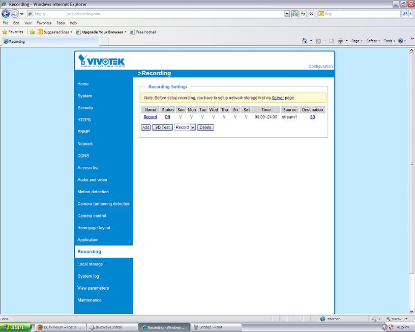

-in the menu "Configuration" -> "Recording":
Is there any setting defined in section "Recording Settings"? If true, set status to "off"

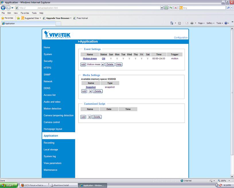

I got it figured out...took some tinkering. It still does the periodic video though. Im waiting for my email from tech support. Im guessing this is a built-in script that is default. Im guessing that typically, these cameras arent used this way, and this is a safety feature so if the network goes down you have some images recorded....until the network comes up.
This is what I have it setup as: (see if I have anything obviously wrong--I dont see anything about periodic video)
Of course you get it, because in the "Recording Settings" you still have an entry "Record" which is "ON". If you switch that off, the periodic video should be gone, and only the motion related videoclips defined in the Event settings ("Motion Areas") should appear.
That was it, I was overlooking that. You were correct, switched that off and nothing but snapshots. Thanks. " title="Applause" />
