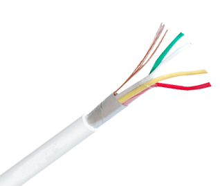

When I say twin coax its actualy a cctv cable with a yellow and white phone and a power connection. I have made sure they dont have foil shield in common and grounded it one end only,

Also what kind of cable is that being used?
It doesnt sound like CCTV Coax? Coax doesnt come with phone wire or yellow wire.

The cable in question is foiled cable with 4 internal conductors. The foil shielding is grounded at my and not the other.
It is a cable that was allready there and is the diy type cctv link cable that comes with a BNC and DC power connector on each end.

HI Stuartbe. it sounds like you are using alarm foil data cable. which is not a good cable to use. and if you are not using baluns at the moment. i would just pop one on each end.

You are correct about the cable type it is indeed foil wrapped TP cable.

I just found this on a residential job I went to check, they had no picture on one camera and barely a picture on another .. but promised they saw the cable working at another job ... was like okay .. hooked it all up anyway since they were paying for the time ... less than 60' distances and full of lines .. switching it out for RG59 siamese.
